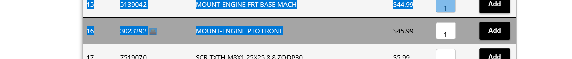

You can use the Pro Mounts- Been holding up better for me anyway than the 16-18 style.
I think if you look back in this thread, I posted that you don't use all of the older pro mounts, The one on the PTO side front is different that the other 3-so you just order another ( like from the mag rear )

new motor mounts again.....
Gents,
I am installing new motor mounts again on my 2017 PRORMK and notice there is a new number listed for the actual mount item #16. (not the snubbers Items 4 & 10)
Does anyone know if this is necessary when changing the rubber snubbers?
