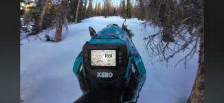

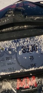

He doesn't have 350hp. Gearing up his 900 boost is losing track speed. 1-1 shift on a boost is 115kmph track speed. Even in his own video he said that the 900 boost is getting 53mph track speed, which is only 85kmph. Those are poor numbers for the amount spent on a 9R boost. A stock boost will see over 90kmph with just SRP cluthcing.
At 2k elevation sure. (From your picture)
A screenshot can show that on a lake just as well as a hill.
Or deep vs shallow snow.
Burandt rides 10-12k
There's definitely a subjectivity to trackspeed claims that makes them apples to oranges......
Not at all, this is at 2077 meters (6814 feet) on a stock boost in a climb vs $67,000 900 boost in a climb at 12,000 feet. Needs to gear down. Will have more track speed. And needs better clutching… lol
2k meters, so around 6500ft.
