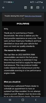

I got the same email. Pisses me off I didn't get my sled until middle of april and they knew about the issue well before that. so that basically tells me they chose to continue shipping sleds out with bad parts knowing they were bad. I would have rather they took longer to get me my sled and sent it out with updated parts. Now i have to haul me sled with 0 miles on it back to the dealer to get torn apart. don't get me wrong i'm glad they have a fix but they definitely could have went about it a different way.
I think most who were waiting all winter on their sleds would rather have had the sled to ride than wait on the filter. Even with the old filter many sleds were still rideable. Better than missing winter imo
