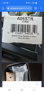

Changed both fuel socks to the ones listed a couple pages back, and no fuel pump whine now. Rode all day and not a peep. Every ride with the stock socks I would get a whine off and on through the day.

I think once it starts to whine it’s on borrowed time . If these mods where done before it did that it might have a chance . I did thermo tec and springs before I ever rode it and so far ok but still early . Going to put the new fuel socks in from O-Riley’s though just because I think it more the full sock then just the spring.
