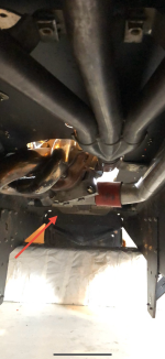

I still have a couple turbo 4 strokes. It’s not an issue pumping the oil back to the turbo, I’m assuming you have that figured out already. One way that we returned the oil on the rear mounts was to build a small oil catch tank so the oil can drip out of the turbo by gravity, into the tank and the scavenger pump can pump it back to the motor. The one in the picture only holds a few ounces. Here a couple pictures of a rear mount Nytro I have.
Im sure you can do a closed loop system like you’re talking about, but it’s nice utilizing the factory oil cooler and oil filter.
