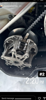

In the latest Muskoka video, his 9r broke like 6 spark plugs in the course of 2 days of riding. Guys, that's f'ing ridiculous!
I only saw 2 plugs blown for the 2 rides he posted, but could be wrong.
One thing i noticed was that he was riding in super deep powder, and getting a pretty good bog when his vents were covered in snow.
Then shortly after that, the plugs failed.
Makes me wonder if the lack of venting contributed to the issue somehow.
Probably just coincidental, but food for thought . .
But ya . . . not good at all to keep riding it until he figures out what is causing this!

I was thinking of Snowchecking a 9R. All of these broken clutches & plugs from detonation are a major bummer. If I owned one I would definitely mix a little race fuel in it . The next problem will be the piston ring locator pins falling out. Hopefully a new map can fix it if there's a lean spot.
Ugh, I just had that happen on my wife's 2018 Ayxs 800 (locator pin falling out ). $2,750 later .... :mad:

I experienced this today. I’m just south of Revy, snow is insane right now. I had a really bad bog with my boost in the deep snow then popped a spark plug shortly afterwards. Might be a connection. I was more diligent whipping my vents and was good for the rest of the day.

Muskoka posted in the comments that he had been though 5 plugs on the 9r as of last week, could be more now
Last ride he did not break a plug with 94 octane fuel from Chevron. He did have a bog but it appeared to clear as he wiped the vents. Are any of you guys that ride above 6000 ft breaking plugs on the 9R?

I have just over 300 miles on my 9R all between 8,500- 10,000' elevation and have had no issues, no plug failures, no p-22 failures, no bog issues, no track issues, no 7S gauge issues. the only thing is the throttle block has to go, it does ice up quickly in deep powder, probably put a TKI one on. So far its been a great sled, time will tell I guess.

In break in it will run more rich so your experience is not as much value to determine if the map is too lean.
