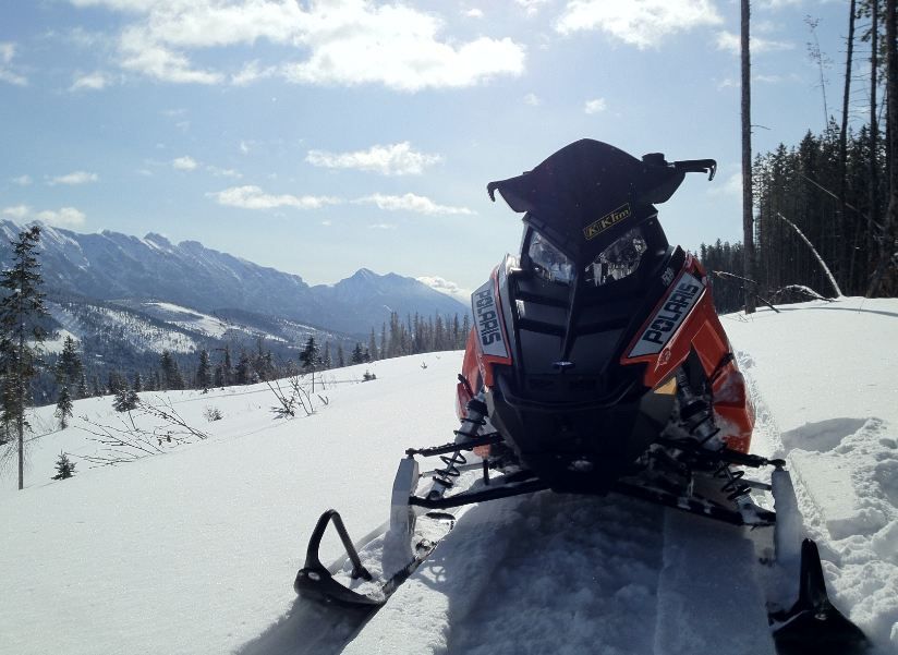

I called Jake Anderson at Raptor Performance Shocks last Thursday and had a conversation about retro-fitting Raptor triple rate springs on the Pro-RMK Walker Evans shocks. I'm an aggressive rider and have to ride bombed-out trails into our riding areas near Elkford BC. Typically I just set the preload on the front springs to nearly full-soft and the track shocks much softer for the rough trails and crank the springs back up once I get to the back country where I take jumps and drops big enough to bottom the shocks if the springs are set too soft. I find the front track spring difficult to set perfectly for the rough trails. It's either bottoming or too stiff. I looked into purchasing new shocks from Exit and Raptor but I can't afford it this year. Both companies offer the springs off their high-end shocks for separate purchase and will sell you the shocks spring-less if you decide to do the full upgrade.
I find the Walkers too stiff and too soft all the time because of this constant adjusting. I ordered all 4 triple rate springs last Thurs and received them today, LESS than a week later, that's Minnesota to Elkford BC. (Note: the rear track spring wasn't on Raptor's website when I ordered them, Jake told me about it when I called). The total cost was $290 USD (including shipping, duty, etc.). Here's some pics of the install. I'll make another post soon with a ride report.

I went out for a couple rides in the last two days and I've been dialing in the preload on all four springs. I was only riding the access trails around town and they are rough. The front suspension is MUCH better. It's plush over small bumps on the trail and soaks up large bumps when riding fast without bottoming. The sled felt very stable. Currently I have the front springs set to full soft. The rear suspension is also much plusher in its initial travel. I tried setting the front track spring soft enough to bottom on hard impacts down the trail. It's tough to tell for sure without doing a side-by-side comparison but it feels like it bottoms less abruptly than the stock spring. This is exactly what I wanted. So far I'm very happy with the results. On Saturday I'll be doing by-side comparison with a 600 Pro RMK that's completely stock. I have never said this before but I hope the main trail into our riding area isn't groomed! I'll compare riding down rough trails at different speeds and (hopefully) how they handle in deep powder.
