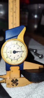

Added a 1/2" riser block to each side of the flap , then a 1/8" delrin extension piece . The extension piece is 3-3/4 " long you can see all the szhat to make this in the pics. The flap ended up being about 5" from the lugs like the factory doo's are . You can also adjust the distance by sliding the rubber attachment points in or out on the Evo Bumper , must say with all the negative and positive pieces I made sure all sides got sanded and painted with SEM trim black like a rubics cube putting it all together 😁 think it should be good to go now will try it this weekend 😎

Nice work arcticridr (y) I think that you'll be presently surprised on how much cooler it runs on the packed snow. I still monitor the coolant temperature, but pretty much don't worry about it overheating anymore.
Thanks Viper , just took your creation and tweaked it for the damn Evo bumper , be damned if I was gonna put the stock grab rail back on . Glad I bought a 24x36 mud flap I have several .... how should we say prototypes on the bench now . The riserblocks helped get the hard part of the doo strap above the factory cat shorty flap(was hitting pretty hard) and helped "push" the angles down , then had to make several 1/8 delrin pieces of different lengths to get it correct, then had to make the left and right , got a couple extra lefts lol Took longer than expected , I have 3 roll around tool boxes full of tools and only a small tub with " wood working stuff" so struggled on some of the shaping , alot of hand shaping 😎 hope it works ,will see this weekend . I did notice one thing when it got the warmest 160°, the tunnel was packed with snow , probably cus we went from 32° and sierra cement to 24° and powder think she got iced up will have to watch that a little closer never had that happen before ???
