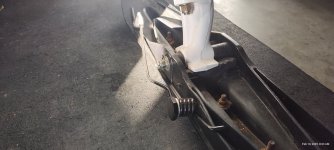

Here is a pic of the sno pro, same set up as on my alphas and 858, noticed yesterday after popping out in the trees and hitting trail temps went to 142 , stopped and one scratcher had pointed forward, fixed it and temps went back down to 135, gonna see if their is room to add a second hole for the short end spring tab to keep it in place , funny other alpha has never done that, flipped forward ,they do seem to help maybe 6-8 degrees . Kinda feel like a porcupine with so many scratchers lol
I've also seen pictures of cable scratchers hanging straight down from the boards at the front of the tunnel. But have not heard how they work.
Yeah me either on those , these seem to make a difference , between pulling over every mile or making it to the back country with some bumping thru the trees enroute to help temps , really curious on MTNVIPER mod, gonna get that done this week should have similar conditions later this week see how that goes .
Yup just went to the trailer and their is room for that second hole to retain the short end and prevent springs from rotating , just another thing to do this week lol

No difference in steering and successfully drilled and retained the short end of the spring , come on TT tree riding is the best 😎😎
