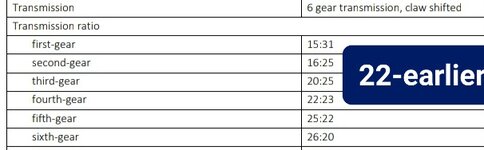

The new xc/xc-w transmission is the same now. Here is how it stacks up to the 22 and earlier XC/TX/EX transmission.
This transmission is lower geared throughout.
1st is 81%
2nd is 83%
3rd is 89%
4th is 88%
5th is 88%
6th is 91%
(% gear ratio of 19-22 xc/tx/ex transmissions)
Stock gearing on my 24 te300 is 13t/45t
Here are the pre-23 ratios for the xc/ex/tx, vs the new 2024 ratios across the xc-w/xc/te/tx/ec/ex line up per manual. The sx will definitely be a better choice as far as transmission ratios go.

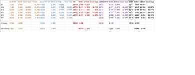

Anyone else notice the gear ratio change for the 25 250 XC? It now has a close ratio 6 speed. I think this would be the perfect snowbike trans. Has the same 6th as the XC-W but with almost identical ratios to the SX on 1-5. Its odd that the 300 does not have the same transmission, but you could put the 300 top end on it. Cheaper to swap cylinders than transmissions.
If They made that tranny in the 2025 300sx it would be gold! Thanks for posting that chart.
