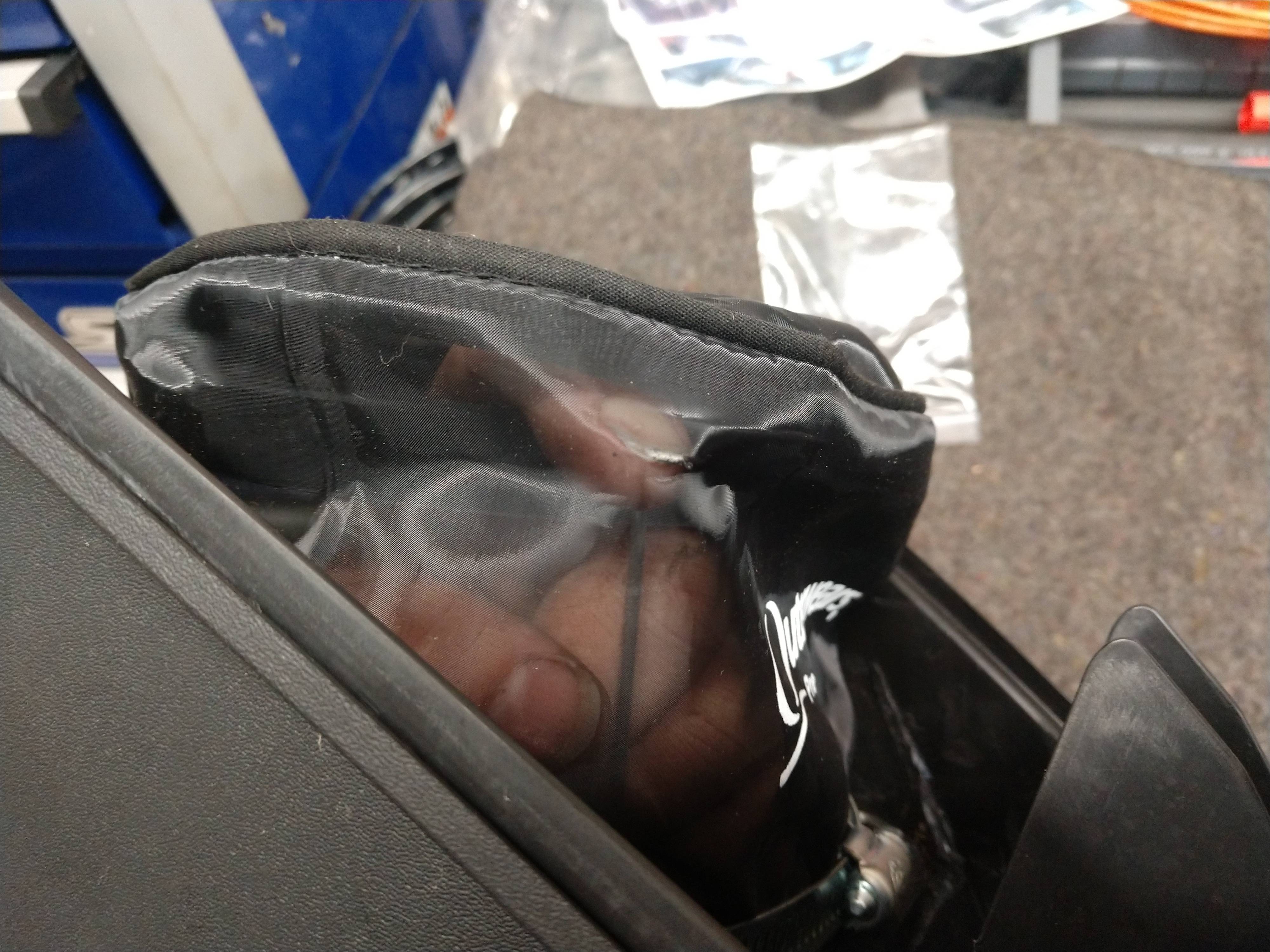

Trying to figure it out a burned a hole in the intake right away. When they say use the defender intake as a guide, use it as a guide to make a template. Or go to the home depot and buy a $25 3/16 looooong drill bit out of laziness.
Tried super glue. Didn't work at all. Now I have a solid spot with a hole in the center. Silicone? Ideas?

There I think I figured it out. The pic posting anyway.
See my fingernail sticking through, so pissed at myself

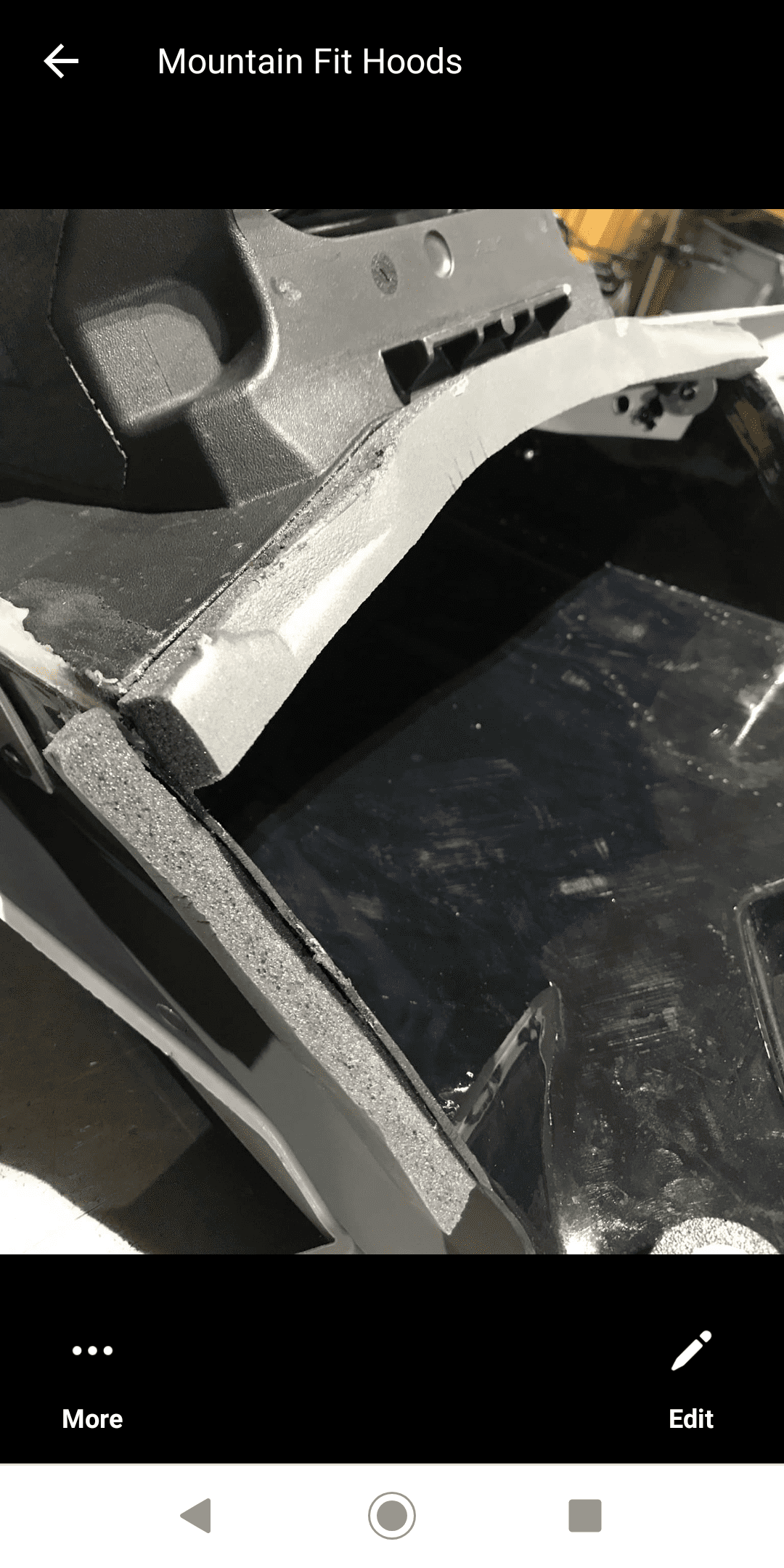

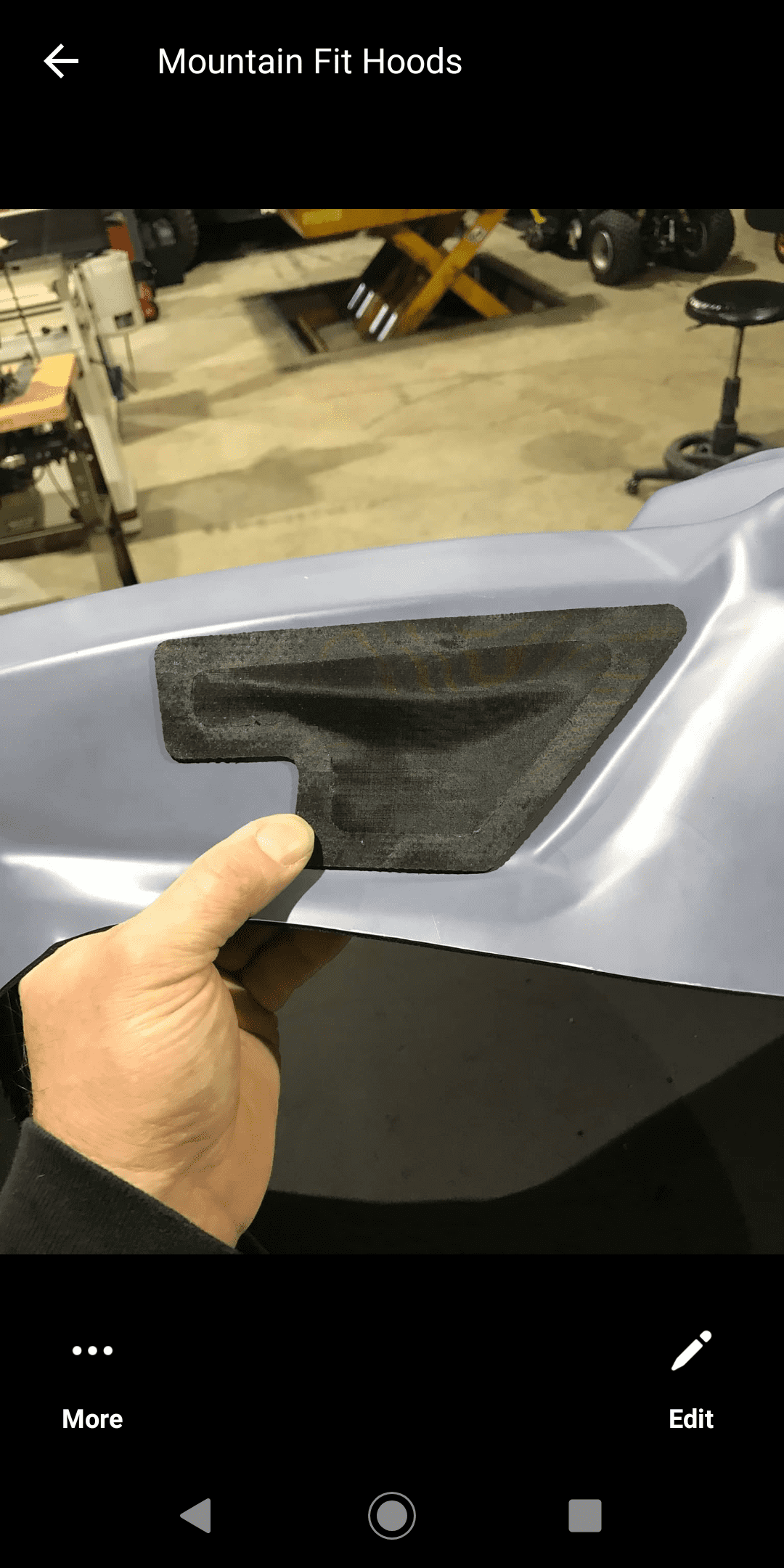

I have been probing people all day on the fb and hygraded this pic that speaks a thousand words.
It shows where the white piece goes as well as how much you need to drill out, about a third of what I drilled out allready. Makes most of that intake vent useless

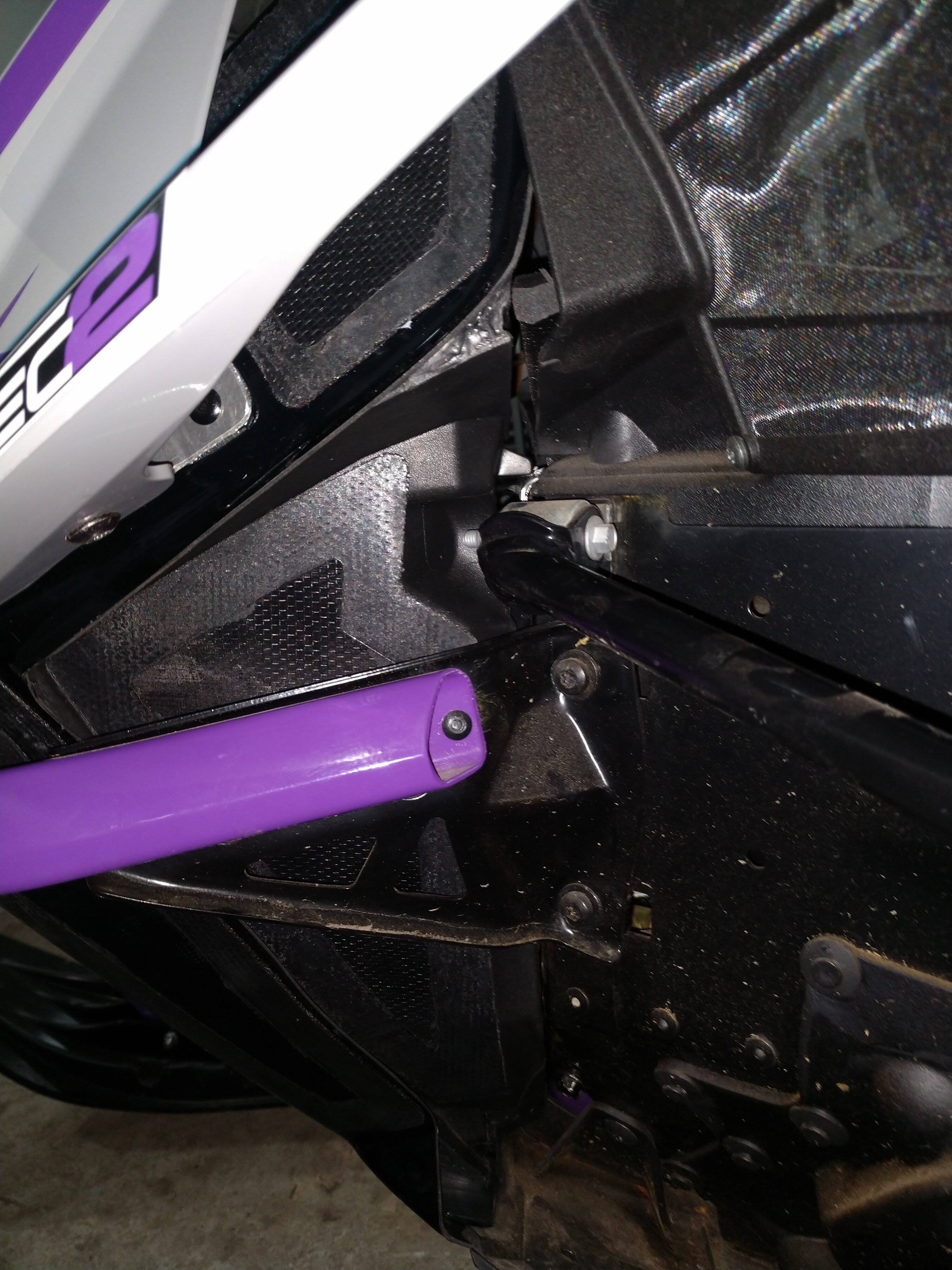

drilled the main mount hole and bolted it in temperarily to line the rest up.
full
Then noticed lots of gap on the sides.
full
I guess I needed to rivet through the hood and the white pieces at the same time
Drilled some rivets out, lined stuff up better and mock assembled while drilling with 10-32 bolts. Still got it wrong and had to re drill one side.
full
Still got it wrong and the upper corner is hanging low, it's glued and I no longer care it's crooked
full
Pretty sure I'll have to drill out one of those rivets again for that bracket that holds the front of the hood on. Plus I forgot to cut the holes for that vent now the box is going to get full of plastic shavings again and I can't get em out now it's all glued togather

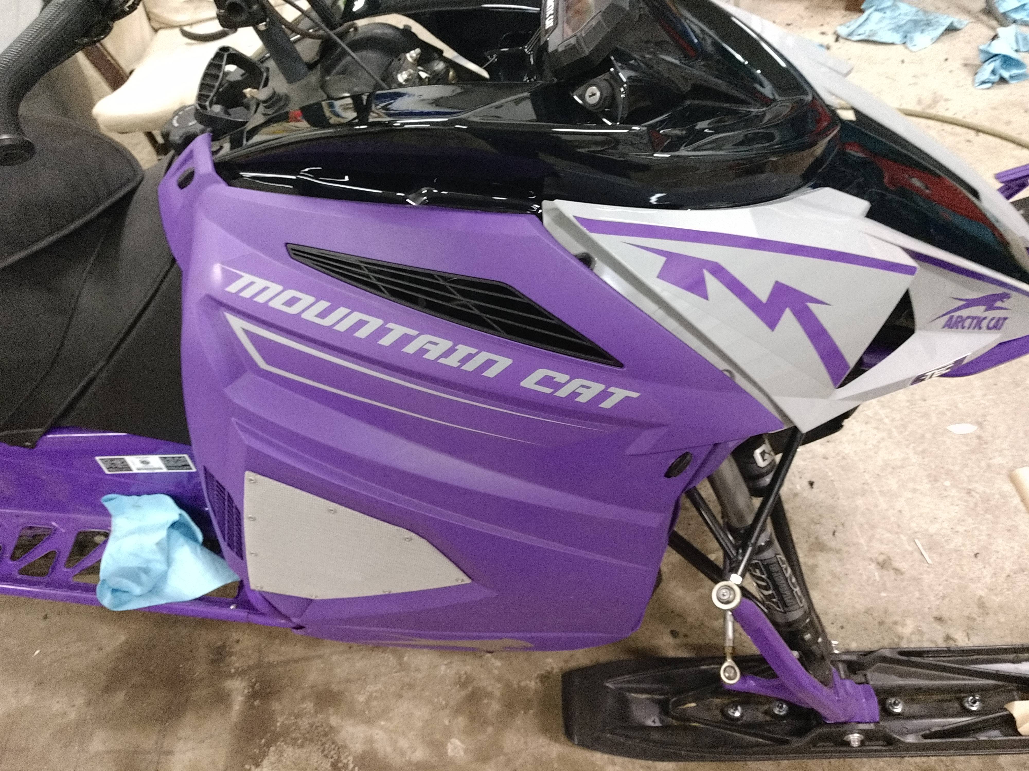

Been at it all day found four rivets in town for two bux a piece, tried to make my own out of a normal rivet with a dremel, fail
Continued putting it togather and hey I'm all the way to the finish line and it looks like absolute $h!7!
full
If you want to use the key switch you have to build a spacer. The poly is half the thickness of the oe hood
full
Guess what the box still didn't line up
full
nor do the quarter turns even come close to the body
full
Real nice
