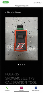

To add another question….. any idea if there would be a setting the meter would read while I messing with the screw I circled in the photo? As in trying to put it back to where it was before I messed with it.
This is the meter I have now.
If you adjusted the base setting.
No.
