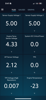

I could really use some help troubleshooting this issue on my sled that I’ve spent the last 3 months rebuilding (replaced bulkhead, engine, suspension, wiring harness, etc.). On first startup after all of this work, I was able to get it to run for about 30 seconds last week, but now it won’t start. It will fire when I pull start it so it’s getting spark and fuel is combusting, but it immediately is extinguished on the second pull attempt (spark plugs are drenched with fuel).
The weird thing is that last week when I got it to run, I unintentionally had plugged the coolant temperature sensor into the ignition coil harness (same plug style
- I’m not sure how it was even able to fire like this). Now that I have everything seemingly connected properly, I’m having issues.
Will these engines run at all without TPS? I’m suspecting an issue with my sensor as the input voltage drops from 5VDC to 0.5VDC when it it is plugged into the harness (short in sensor?). I did previously have the sensor functioning properly yesterday though so I don’t think this is my only problem. It’s almost like I fried something or have a weird short somewhere. I should also mention that my temperature sensors are all reading erroneously (way, way off). I’ll attach 2 screenshots from EzLynk (1=TPS unplugged, 2=TPS connected).
Any input is greatly appreciated. This was a big project and I’m going to be bummed if I don’t get it out for at least a couple rides this season.
