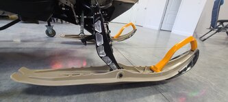

I was asked for more pictures of the RS spindles on my sled and also wanted to share my impressions after another day of riding. I let out my limiter straps (two on the Expert) and also added more air to the front track shock. I swapped sleds again with my wife a few times and this time we’re a bit more consistent on our impressions of the sled. She thinks it tips like a Polaris now and has a larger sweet spot on edge which matches with my previous impression. Another friend that rode it thought it had much heavier steering and I was noticing it too but the snow was starting to warm up. I noticed that it has heavier steering but I don’t think it requires as much steering to hold an edge and it changes direction well with lean angle instead. I never felt like I had to have the skis locked in a counter steer to hold a side hill like I have in the past. We all agreed that it crossed old tracks with more stability but that is likely the shocks more than the spindles.
Sorry, I don’t see how to rotate the image. You can see the RS spindles on the Expert (black/orange) next to the stock spindles on the all black Summit X. All I needed to make this work were the spindles and ski rubbers from a 2018 Summit (same rubbers for 2017 through at least 2020 non-Expert).
