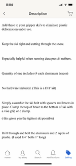

Drilling the plastic and aluminum at the same time while clamped is key.
Sorry no video.Do you have a video of installation? I thought I had seen one a while ago but I cant find it.
Any photos or written instructions? Just want to make sure I do it right the first timeSorry no video.
Thanks! Just ordered two sets![]()
Polaris Gripper Ski Braces Axys Rmk Pro 600 800 850 | eBay
Condition is New. (Arctic cat skidoo Polaris yamaha). Add these to your gripper ski’s to eliminate plastic deformation under use. Simply assemble the ski bolt with spacers and braces in place. Clamp the top of brace to the bottom of ski with a vise grip or c clamp.rover.ebay.com
