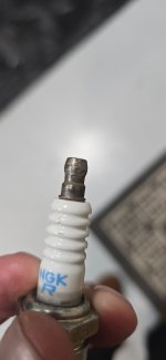

So this is going to be a long post. I'm hoping you guys can help me learn a little more on this clutching business. I know there's lots of ways to get almost the same results. I'm open to any advice you guys are willing to give me.
858 154 3 inch. I didn't even ride the factory clutching based on what I've heard. I bought a setup from BDX and it seems pretty good but I'd like the clutch to engage a bit lower than 4000 rpm. When loading and unloading, as well as when trying to pass slowly and nicely when you meet xcountry skiers/hikers 4000 just seems a bit fast. Seems to chatter a bit (engaging/disengaging) when I try to travel at that speed. My only riding so far is the Black Hills at 6-7k feet. I saw 8250 rpm and it seemed to have more left but I didn't want to push it anymore which makes sense for the lower elevation. I normally ride 9-10k or a bit more (Snowies/Bighorns/Steamboat). I do have a Jaws trail can, and right or wrong the ring behind the primary may be in my toolbox. Heres the setup.
Magnetic weights 60 gram base with 4 magnets. 1.3 grams each so 65.2 grams. Distribution from the heel of 2-1-1-0.
125-290 Primary Spring
190-260 Secondary Spring
Helix is a 7TM-52/40.20
Thanks.
Edit: What could I expect with a 105-280 Spring? From what I gather engagement woukd be lower but what will I see on the upper end a little less spring?
Edit #2: Ordered the 105-280. I also ordered a Thunder Products primary spring washer set. Going to try 1 glide washer plus the lighter spring. I feel like I should try to keep the finish rate similar. Hoping the 1 washer will help that. Hoping for 3600ish engagement. I think I'll also pull one weight and run 2-1-0-0 and test when I'm in the Bighorns in a couple weeks.
