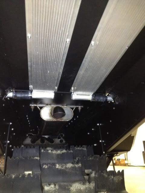

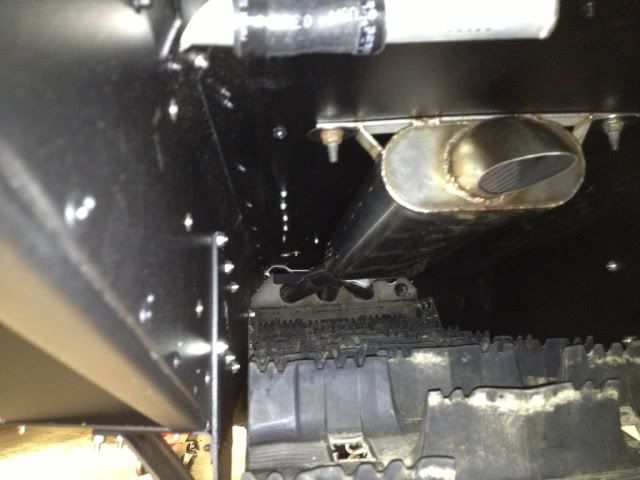

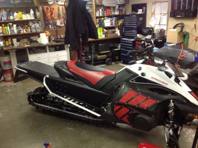

Here is what I did to my s/c nytro. I bought the muffler used off eBay for $150. Sounds healthy but not too loud. And the extra room on the tunnel is great for storage.
I really like what you did there irondave86. Do you recall who you got the muffler from and/ or the part number. Being thet mine is and apex with an Expert X skid, I don't have as much room under the tunnel. I was able to lower the skid 3/8" which might allow a muffler like the one you have. I would also have to change the coolent crossover. Eithe move it further back or bring it over the tunnel.
Can you give some specs / dimensions of the muffler and also maybe a link to a similar one on ebay? Is it a heavy automotive muffler?
I believe it's an SDR setup. If i recall his user name here and on "totally yamaha" is "stopdropanroll" I'd say its 1/2 the weight of the stock muffler.
I found mine used on eBay, I took a chance and couldn't be happier. (Was never a fan of how the skinz looked or sounded) The tone of this is nice and the craftsmanship is top notch. Wish I had more info for you, but this is all I could come up with. I can get exact dimensions next weekend.
