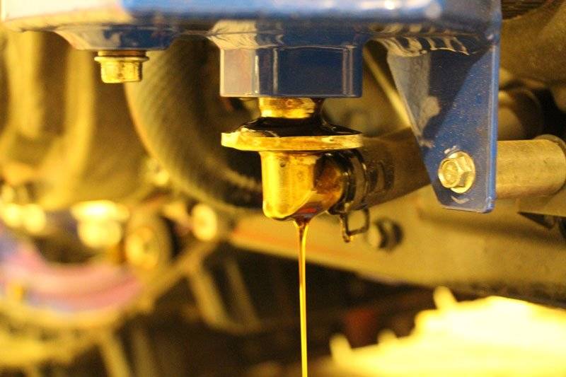

Disconnected and drained the oil tank (and trashed an O-Ring)

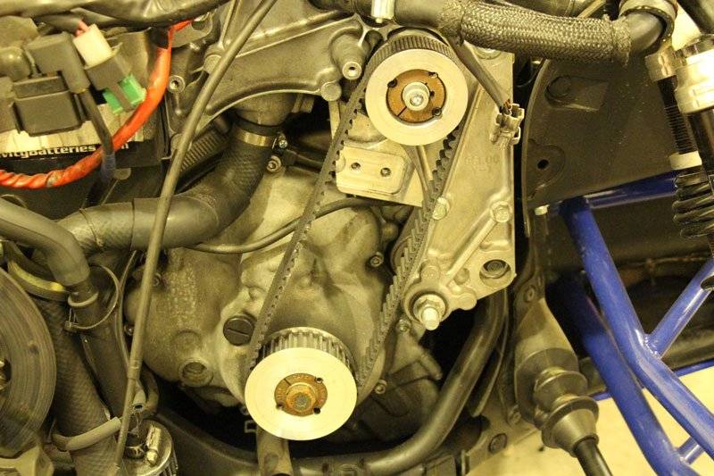

That let me have my first real look at the belt and pullies in 2 summers.
They looked REMARKABLY GOOD!
NO SIGNS OF WEAR at all!
Here I discovered that I HAD replaced the short tension bolt with a LONG tension bolt at some point after I did my initial installation. Obviously needed a little more tension after I did the first required "Tune-Up" and failed to report it in this thread.
Notice how far that bolt is sticking out to the Left.
That is FULLY Tightened. So when I went to loosen it, it only moved about 1/4 inch.

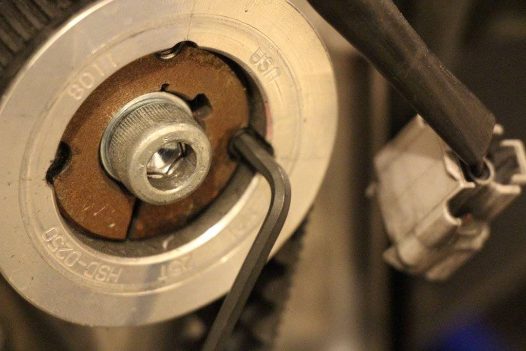

Removed both of the set screws from the bottom pulley with NO problem.
They were TIGHT, Very TIght, but they squeaked out.
But the top one was a whole different matter.
BENT the Allen key and BENT my Allen Socket!
That screw is NOT coming out with the tools I have on hand.
Loosen up the pulley bolt...
It was already fully extended.
I was able to back it off about 1/4 inch, and even then the pulley itself did NOT budge in the bracket. It was not sliding.
Had to remove the bolts under tension and then knock if of with a rubber mallet.
Hex Head Insert Bit for 1/4" Hex Drive, 1/8 x 1" Long
I remembered that during the install I had to get a special High-Torque bit to install the set screw.
Dug that one up out of the tool check.
Sadly, that didn't work out so well.
It twisted as well, AND the set screw stripped in the process.
Life is NOT good right now.

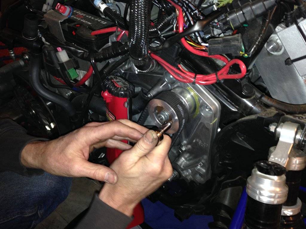

First thing he does is to take one of my TORX head bits and POUND it into the set screw with a hammer. Using the torx ridges to BITE into the now stripped screw to see if by chance he could loosen it up and back it out.
No Joy.
This screw is NOT budging for love nor money!

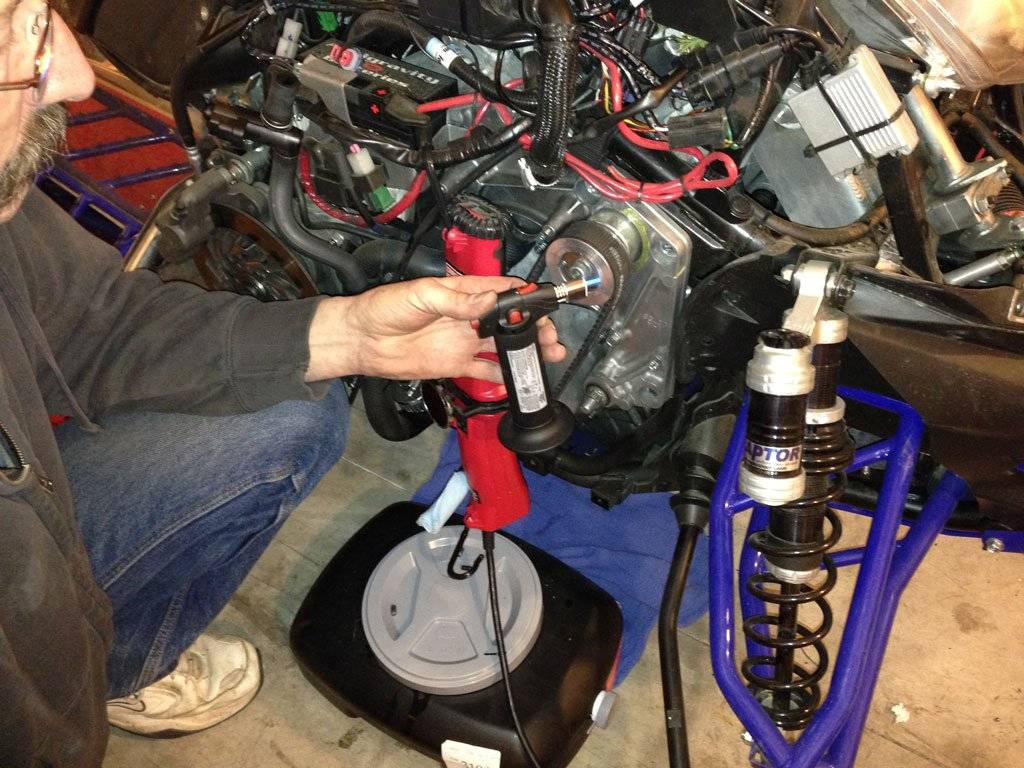

Second off he grabs my little micro torch and starts warming up the set screw
After warming it up a bit he tries to back out the set screw again.
No Joy.
This little sucker is happy right where he is.
Not to be dissuaded he POURS ON THE HEAT and gets it hot enough that I fear for the well being of the belt!
With it good and HOT he pounds the torx head back into the set screw one more time and sure enough, it backs out.
Using the Torx head was one of those little tricks that just NEVER even dawned on me.
