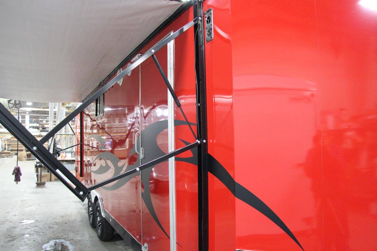

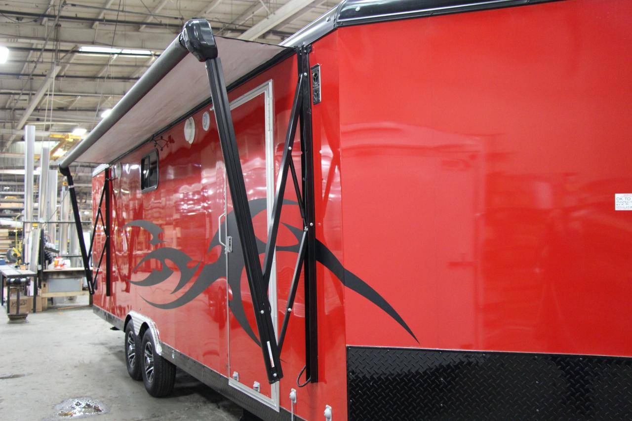

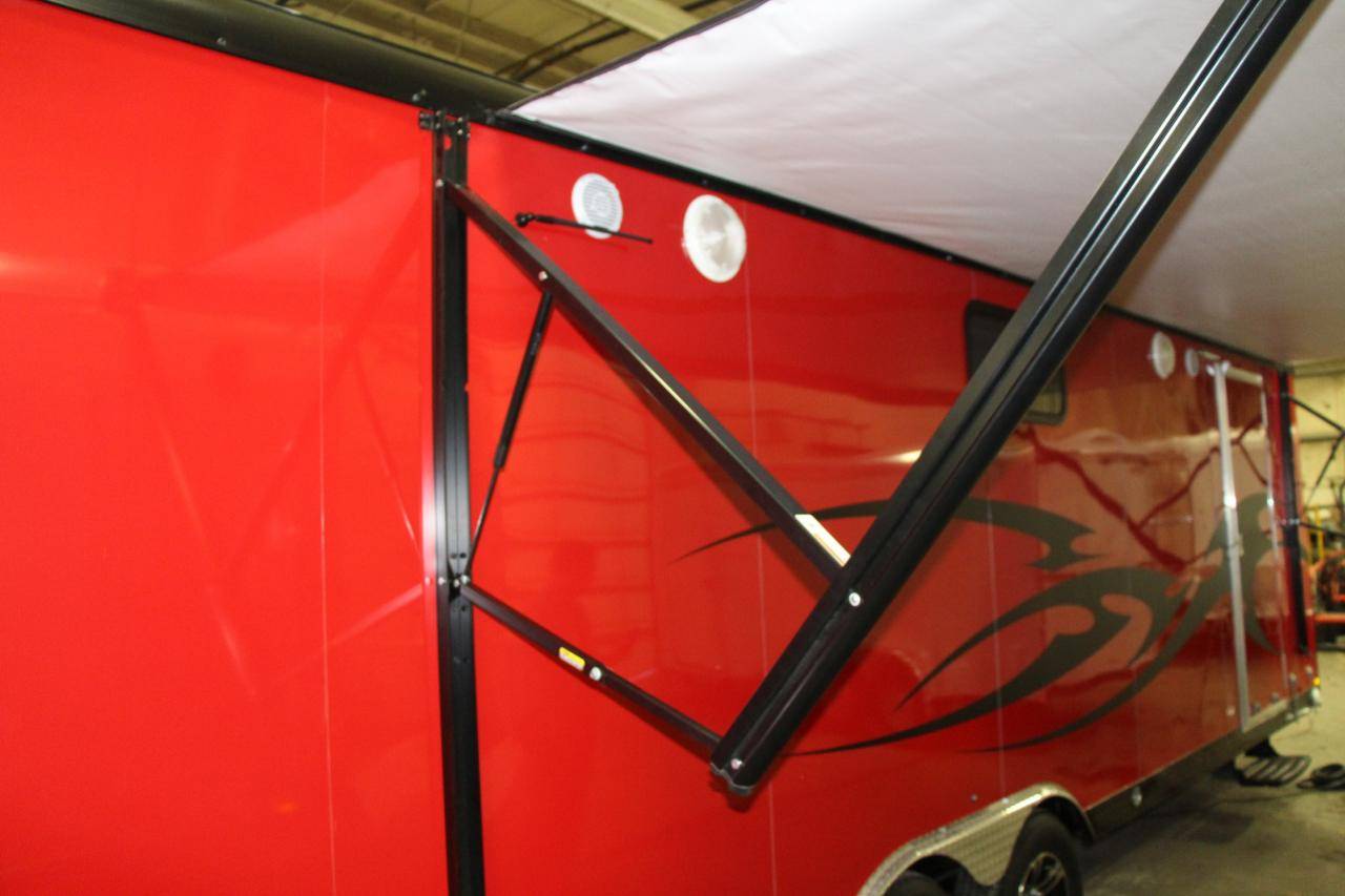

So I asked Mirage to include a full size automatic awning that would allow us to set up chairs in the shade during the daytime and enclose the the Light and Music in the night time. This is what they did for me!!
AWNING STORED FOR TRAVEL.
Hit the button inside the door and the electric awning begins to unroll itself.

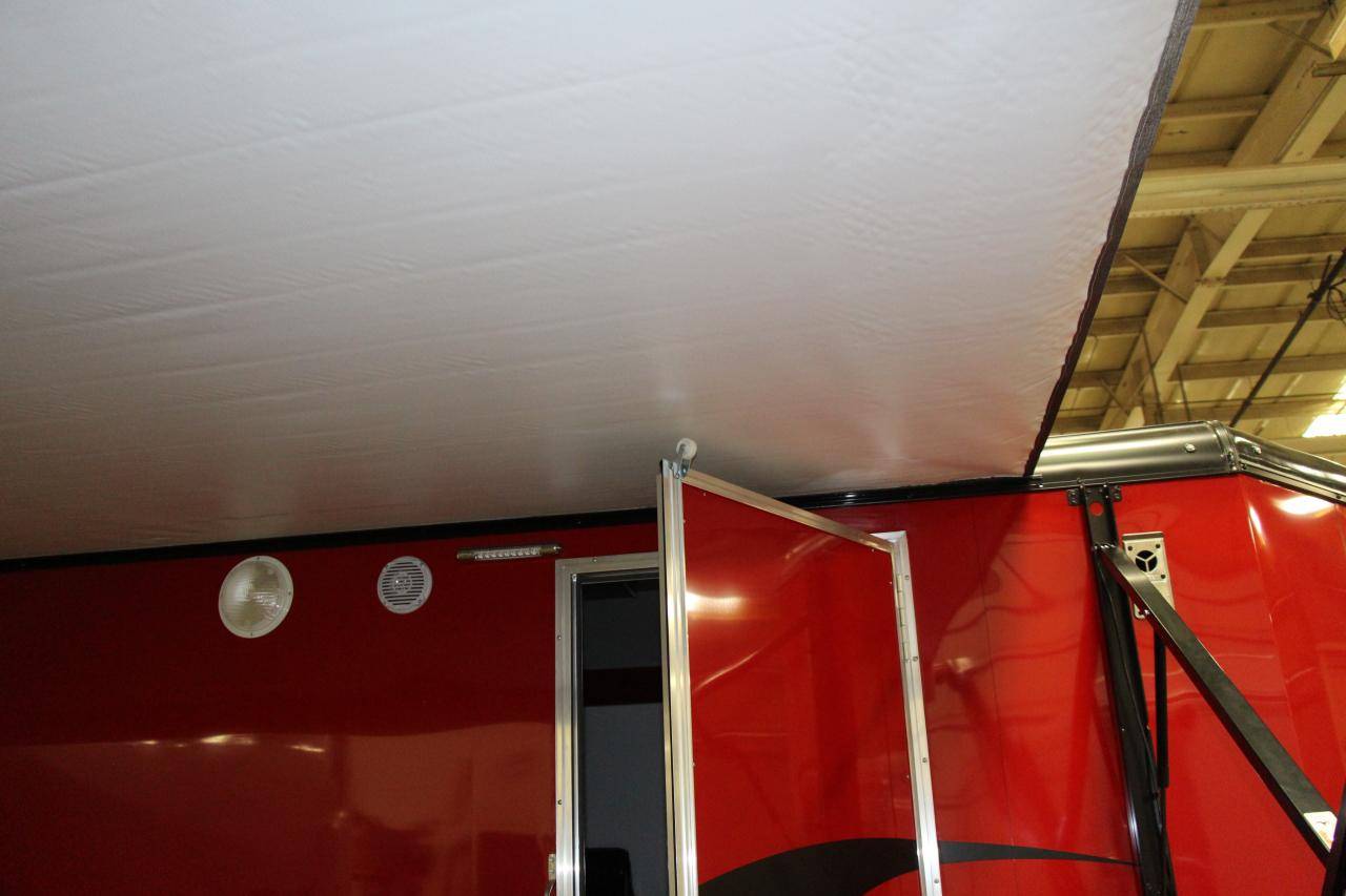

Nice attention to detail.
Opening and closing the main door COULD destroy an awning if you weren't paying close attention and allowed the door to scrape the cloth.
Mirage was smart enough to add this little ROLLER to the top JUST IN CASE the awning was sagging or blown down at the moment the door opened!
2 VERY cool benefits of this awning.
1st, it REFLECTS all of the light from the external floodlights I had installed and creates a very pleasant environment to sit in at night.
2nd, the music from the speakers is also gently reflected down making the sound MUCH nicer to listen to !
