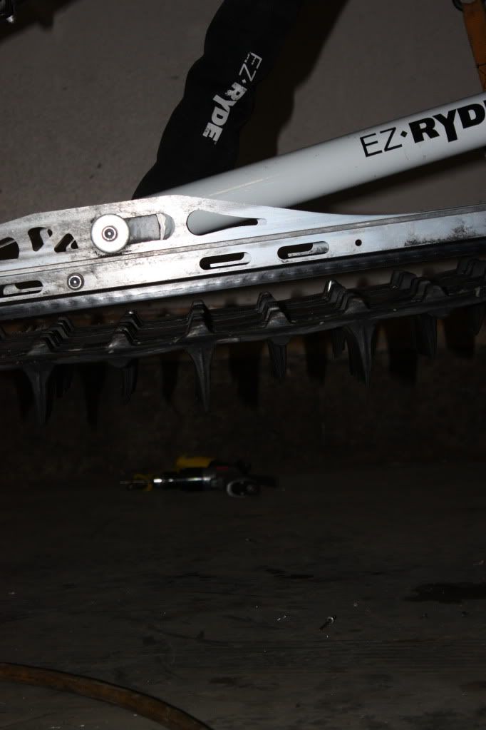

I've been running my 162 EZ-ryde on a Cat M7 1000 big bore for a few seasons and lovin it. This year I turboed the sled and I can't get the track to quit ratcheting under power. It doesn't ratchet constantly, just occasionally at the first quick roll on of the trottle. I have the track so tight that the sled won't roll back off the sled deck. That can't be right!:face-icon-small-con
I checked with the folks at EZ ryde and confirmed the mounting dimensions. It's within 3/8" of spot on. I'll follow up with them some more, but I thought that one of you might have some top secret formula that helped with your problem. What do ya think? Any experiences with this perdicament that I'm in? Either post here or PM me, please.

I am curious, how do all the turbo 1200s use the stock drivers and stock skids. They have the same factory dual extrovert drivers? I've inspected my drivers and they look great.
I noticed that some of my clips are missing. The track was only clipped on everyother and now I'm missing about 8. Do missing clips make the track ratchet or does the track ratcheting make the clips come off (chicken-egg)

I ran an Ezryde on my 172" Nytro with 330 horse and it never ratcheded my Avids. I ran my track banjo tight. Did you inspect the drivers to look for mushrooming? May be silly but check your hyfax wear as well.

I'm used to running it really tight, but now it's so tight that the thing won't roll off the deck. Checked both stock extrovert drivers and they look great. Nothing obvious. I had the back of the suspension mounted down about 3/8" but I put it back up to spec to see. The hifax are getting worn, but not sure what effect that has on ratching?? Got in and serviced the bushings and checked all aspects of the alignment...everything looks great!

I have had two of them and IMO they won't work with stock drivers. The back end wanders on the EZRyde and it creates space on the drivers. I recommend trying some Wahls or Avids. It should be tight but not so tight it won't roll

Well that 3/8ths of and inch made a huge difference this weekend. Got it to quit ratcheting and it was still loose enough to roll...not super easy but it rolls.
Talked to the Avid guy. He can make me drivers, but was also thinking that it was something in my suspension setup. Nice folks to talk to.
Thanks everyone!
So which shock mount did you move and which way did you move it?
