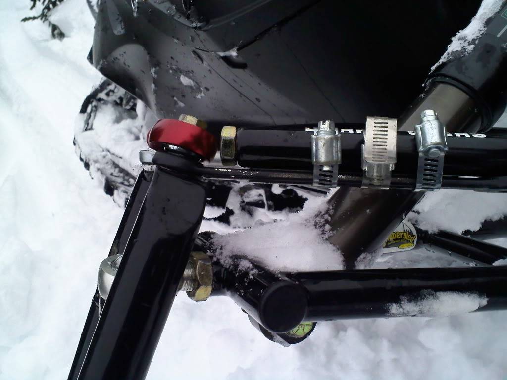

Hose clamps and a large wrench work even better for that.
The box end of the wrench can even replace a ball joint in an emergency. (Bolt, washer, wrench end, spindle then nut)
A page out of my play book :)
