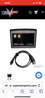

It was pretty easy just to order from them direct. I think I got mine in less than a week. There are a lot of skidoo dealers not on that list as well. Can also get from evolution powersports
You aren’t able to order from them direct. Seems you must find a distributor. Thx for evolution powersports recommendation.
