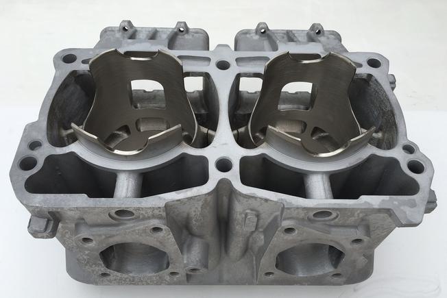

I think a more user-friendly, elevation flexible BB for the 850 would be a better seller to the masses... something that benefits mostly from the increase in displacement rather than than a 'higher-strung' state of tune.
No doubt that a 290cc addition to the 850, to yield 1140 with 95mm pistons, a 33% increase in displacement, would have a considerable perk in the performance department.... Getting those cylinders with those bore sizes would be a bit of work however.
Not sure if a bore and sleeve could yield the 95mm bore required for th e1140 and still leave enough metal to have sufficient transfer port sizes. utilizing the stock ROTAX-850 ETEC Monoblock cylinder casting.... Or would a billet or custom cast Monoblock be required to pull that off.
Not to discount the more race-inspired kits out there.... those definitely have a place for many performance enthusiasts.
