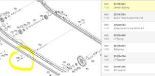

Hi, do you mind me asking why you have this part on one side and not the other?
Hey sorry didn't see this.
Um, thats how it came? I was going to say maybe I put it on backwards, but that pic is from before I changed the rails so thats how it came. Thats how it came from Lynx. Beats me lol.
Buddy I sold sled to was asking about it too. I'm not sure why it even has that weird spacer on one side in the first place but thats how it is from Lynx.
HECKS
Dec 21, 2007
419
249
Sylvan Lake, AB
Would it be a 'Stop' for the suspension pivot arm ? As to not over pivot forward. Parts fiche reads as 'Limiter bushing'.
I recall seeing photo of a Lynx rear suspension over-cam'd forward last year.
