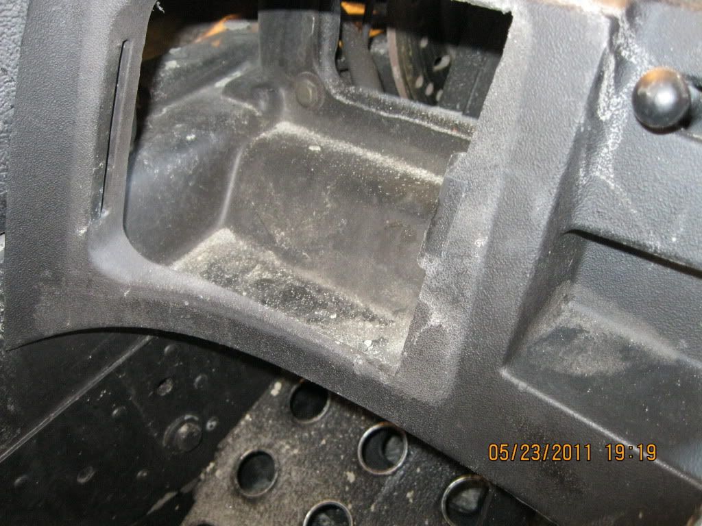

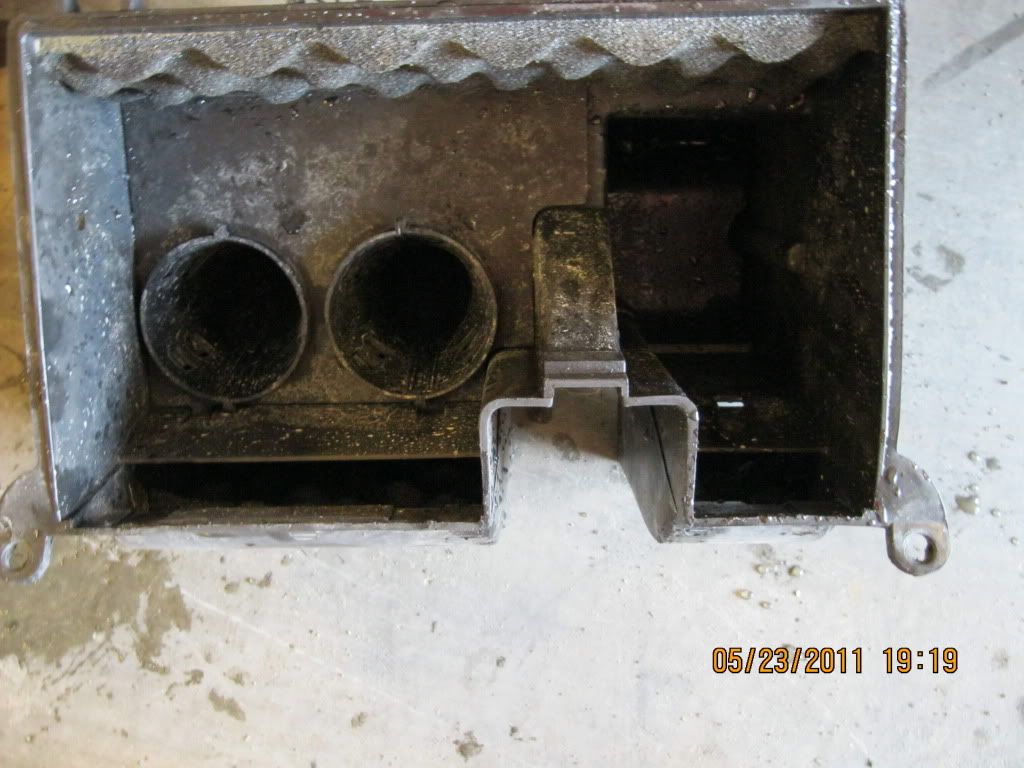

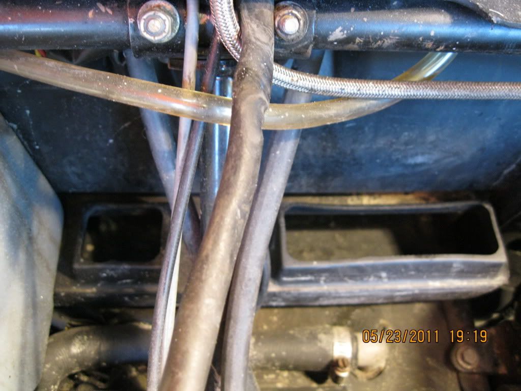

I've got a 98 600 zr that I'm turning into a water skipping sled, it does pretty good stock but I've got some things I'd like to try. I'd like to do away with the cowl fresh air supply
and try extensions with pod filters thru the top. Will I be able to still draw enough air? I think I can plumb right out of the box and thru the hood to get fresh air, has anyone tried this? Any other suggestions?

I blocked off the cowl intake and drilled a 4" hole in the top of the airbox to mount the timbersled intake off my 09 700 polaris and it worked great. I'm going to try dual pods thru the hood next week, just hoping the sensor that was in the airbox doesnt mess with it.
