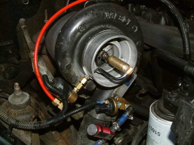

How about all the diesel guys that fog the compressor along with the charge pipe as part of their checmical intercooling? Works perfectly fine...
EDIT: A few seconds of search did reveal that the old factory turbo transam's were drawthrough carbs.

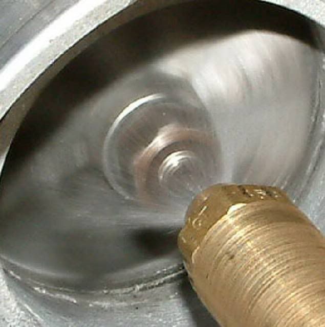

As for dumping chit in pre-turbo. check this out... somewhat common in the diesel world for those guys that fins their 3 or 4 5-10gph nozzles int he charge pipe are not enough. You start dumping it in the compressor, which in theory, chemically alters the compressor map of the turbo.
Heres one setup, appx 8gph. No problems with the setup at all. Also, being that the nozzle sprays in the 2-3 micron range, its alot better than the 20 micron dirt the factory air filter lets through!
