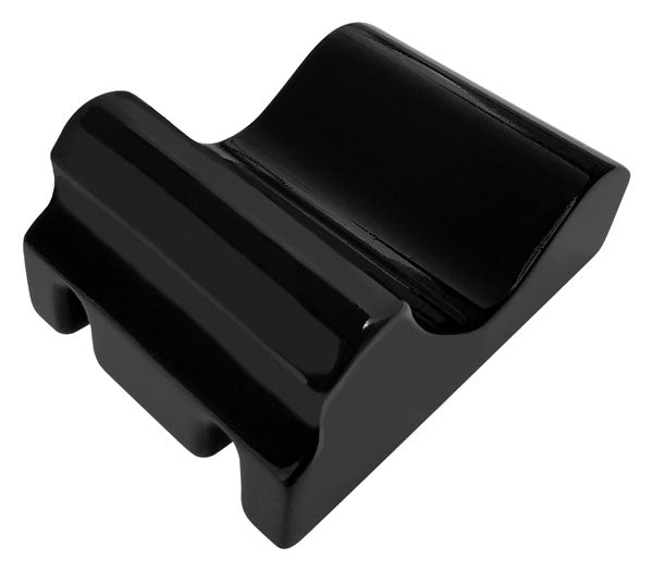

-Make sure that ski rubbers are always in good condition, cheap fix if you feel that they are getting too loose. Replace the originals at least every 500km. Would go for salazzking or durapro ski rubbers for the best long term solution.
