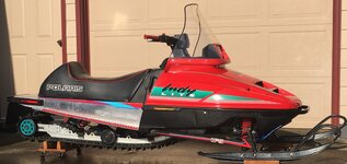

I bought two 1999 Indy Lite 340's and I am in the process of long tracking them. I put a 133.5 x 1.5 track on one and am in the process of putting a 136x 1.25 track on the other. I also put X10 rear suspension brackets on and moved the front suspension bolt hole down an inch as well as 11 inch tunnel extensions. They look like mini RMK's now!
The stock gears are 17/41. The lowest gear I can get for the top gear is a 16T and the bottom gear appears to be the biggest one that can possibly fit in the case.
Ideas? Is it worth it ($35 each) to drop one tooth? Is there something else I can do? I am concerned about bottom end performance/ burning belts, etc.

I put a 136 x 1.25" under my '94 and geared it to 16:39 with a 64 pitch chain.
Your 17:41 is virtually the same gearing. Mine had no problem with me and the kid out in knee deep snow tractoring around. Combined weight was over 300# so I was grinning from ear to ear on that sled.

I went ahead and dropped the 16T gears in. Haven't had a chance to get them out test riding yet but just getting them in and out of the shop, on and off the trailer, etc. they don't have that low end bog/hesitation they had before so I think it was a good move. I have them at a buddy's place right now cleaning the carbs - I always fail at that job! Both sleds are now virtually complete so when I get them home I'll take some pictures and post them up. I'm excited to get them out on the snow! I think the boys are really going to love them! I want to chop the windshield/ add a mountain bar to one of them - the other one someone had already done and it made the sled look really good.
