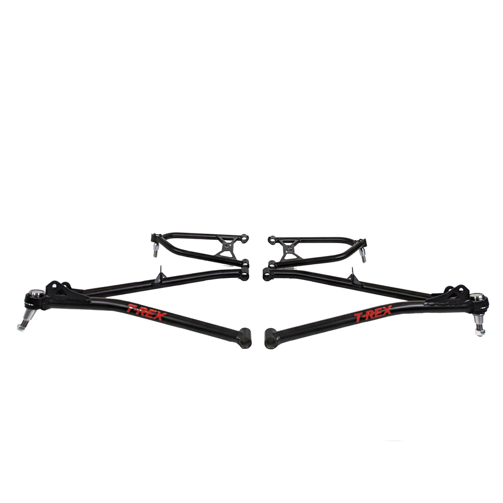

I swapped my 2024 Freeride 36” front end to a 34” using stock parts (upper, lower, and tie-rods). The factory shocks won’t clear so I went with FOX Float QS3 Lightweight from IcAge.
You have to run the billet upper an arm kit to clear factory shocks. Standard chrome moly will fit with fox QS3.
They told me this fit with org. freeride/shredder re shocks
nice to have options. i didn’t see if the trexfab kit comes with tie rods like the Zbros does but I was able to use the stock tie rods anyway.
