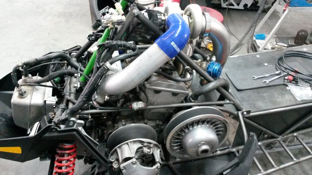

My life would be complete if i had a shop with tools and knowledge to build a monster mountain sled. Looks exciting!
It is a lot of fun! I get a lot of satisfaction out of building them as well as riding them afterwards. I looked long and hard at just buying a new model this year but after looking all of the big brands over I just felt nothing was up to par. Figured id build one that covered all of the weak spots of the other brands. Hopefully im going the right direction!

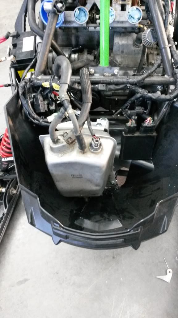

Also my temp oil tank location. Thinking of making one of these ot of carbon also. well see how much time i have this summer
and my air box. Never built one for 4 cylinders before:face-icon-small-win

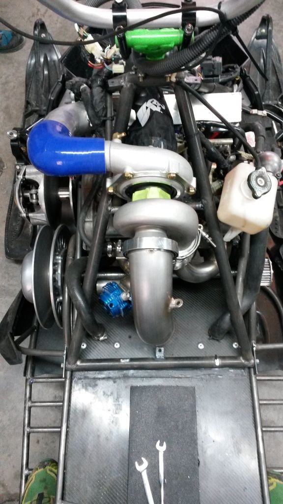

got my turbo mounted for good. It turned out about an inch lower than i had it before

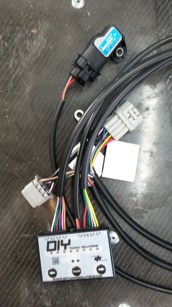

Also got my fuel controler. has an external 3 Bar map sensor that will help the fueling compensate for boost and tempature.

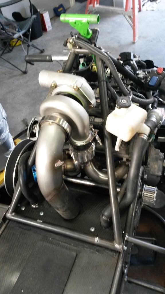

tacked up my air box and charge tube. Ill be running less than 10LBS for now so no intercooler. If i find myself going over 8 ill look into charge air cooling
