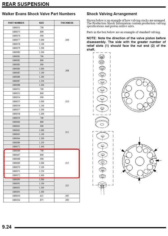

Who does some revalving on the Walker Evans air shocks on the dragon RMK's?
I have heard of one place but can't remember. I want to make them a smidge stiffer as I'm 200+lbs. The stock while great on the trails around the midwest when you are standing up or leaning forward, side to side I just feel after a year they could be a bit stiffer/more resistent.

I have a set of the Factory-Walker Evans high flow pistons and firmer valve stack that I'll sell for $60 shipped for the pair.. (this is the piston with valves only... not the whole shocks)

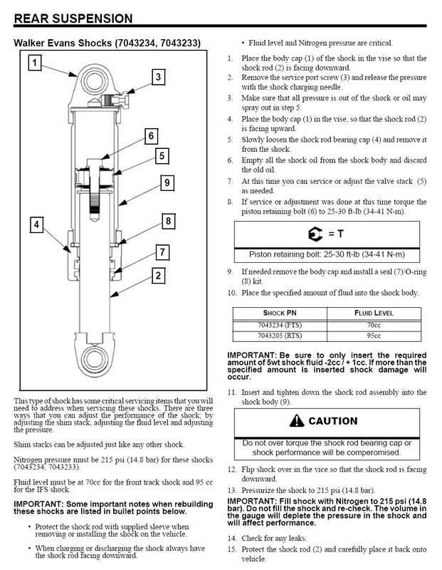

Got these directly from John/Randy at Walker Evans. Should take good care of your needs. You would only need a simple service on the shocks and recharge them to 225 psi (10 psi more than stock)... rockin.. Any shop that can service shocks can take care of this... The WE Airs are the simplest shock design out there.
I believe these are the same pistons and valving that FasTrax is using.
As a note: Go to the hardware store and by a stick of $2 foam pipe insulation and cut it to length BEFORE you remove them from the sled... The shafts on those shocks can get knicked up very easily.

To stiffen them up a tad (no where near the revavle like FTX or I'm selling)...
add 5cc (no more) for a total of 100cc for the front ski shocks and take them up to 225lbs of Nitrogen charge from the 215 stock.. more and you risk blowing out the shock.
The WE is the simplest shock out there, pretty good as a shock for most Mountain apps.
