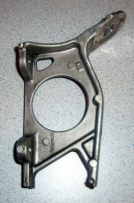

Take a gander at your aft/PTO motor mount bolt (behind and below secondary clutch)......and see if the bolt head is missing. 2 of the last 3 sleds in the shop this has been broken, one caused clutch damage when the clutches came together. The other was unaware it was broken. Just a heads up :beer;:)

Can you post a photo and or diagram of the problem?

i saw one like that last year and the clutchs touched and caused alot of damage,i was thinking of getting some higher rated bolts to use
And, just to add a little here, that same motor mount broke on my sled last year. So, add this to the list of stuff to check on a regular basis...
Don't forget to check the front PTO mount. Found this on mine last year.:mad:

Gus, Do you think the clutches pulling together may be a cause also?? That is what it looks like with the direction of pull....???
Both these sleds don't see huge impact, nothing but powder and soft spring snow...and neither guy is a bump rider. These were both stock '08 Summits.
Looks like a good opportunity for someone to make a bracket that goes under this bolt head and down to the stud a few inches below to lessen movement ????:beer;
I built a brace that goes from the secondary jackshaft support mount and bares right on that bolt head you are talking about. That eliminated all movement from the clutches.

Does it go to the upper bolt of the jackshaft support? Or to the lower bolt?

Brew, niether. It mounts to the front side of the jackshaft support. Just clears the back of the secondary at full shift. I used a piece of 1/8 by 2 inch steel strip and it is shaped up around the bottom of the jackshaft bearing a bit. I just used an adjustable bolt setup on the bottom to limit the amount it can flex. I need to build an updated version with a rubber bumber and a bolt on push point for that to bare on rather than the bolt.
I think Gus is right though...I just looked at mine and the head of that motor mount bolt is gone!
