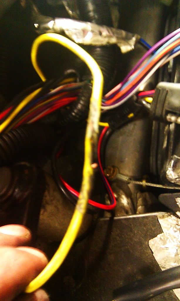

I about pulled my hair out tracking down the electrical issues on my hcr, and finally found the problem today. My gauge wasn't working, and would only work if you wiggled the wire harness. I finally found a wire that had rubbed through right by the back of the airbox, just spliced it, and its back to normal. Tim
