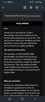

S-22-03 Fuel Filter Update is official. Polaris needed to do this - sometimes the dog that 'whines' gets a bone. All 22 Matryx RMKs at a minimum. Glass half full - here's to closing more design/execution gaps going forward.

Nice - Be good to get this handled over the summer. Thanks for the heads up. Missed the email
Look for it in the mail as well. I did not get an email but instead a notice through good ole U.S. Mail.
Yes get it done now if you can!
I got the recall done yesterday (Polaris part # 22009832) and took the opportunity to get a VOHK tune and Diamond S quiet installed. Took a nice little rip through the neighborhood. A great summer day!
