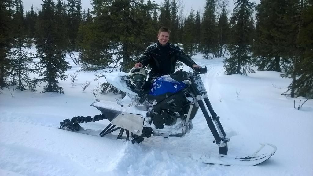

here is last years gsxr 750 -03 ,140 hp and about 195 kg(429 lbs) without fuel ... target fore this 1000 is 185 kg 407 lbs

i choose an -08 gsxr because the frame best fore tedesledd conversion , the bike will have wheels and go on the streets in the summer. on deep powder days a have my 300 smoker to use so the gixxer will work fine with 129 trac later in the spring ...
