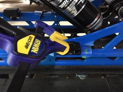

I used the supplied mounting template to figure out the general mounting location. I ended up straddling the triangle cut out just behind the front rear shock (right side mount):
I clamped the actual mount to the rail and drilled through it vs. using the supplied paper template. I snugged it against the lower rail for additional support:

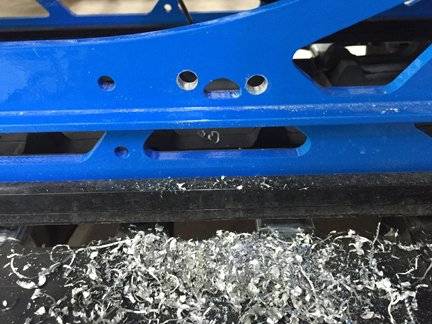

Drilled mount holes:

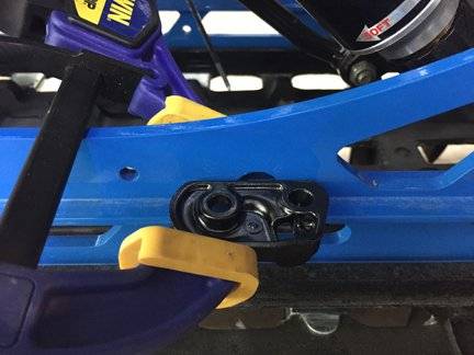

I again used the template to locate the mount point for the ice scratcher support, again using the bottom of the rail for extra support. This support also keeps the scratcher off of the painted rail.

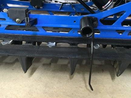

Finished in the up position:
Down position:
Install is very clean and the scratcher looks like it's going to dig in well and not bend/break if I forget about it backing up.
