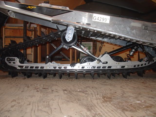

I have the smittys brackets on the rear of mine. I also drilled the front out in two different positions so I can experiment or 'tune' the suspension during the season to see what I like better.
The drop brakets
These are the holes up front that I drilled. The top hole is stock. I took the backing plate off of the inside of the tunnel and used it as a template for drilling. My goal was to keep the track at the stock angle as much as possible.
Some guys don't like to drill holes in there Tunnel/Machine and to be honest I didn't like to do it either lol but I didn't want to mess with the holes during the season if I wan't to experiment.
