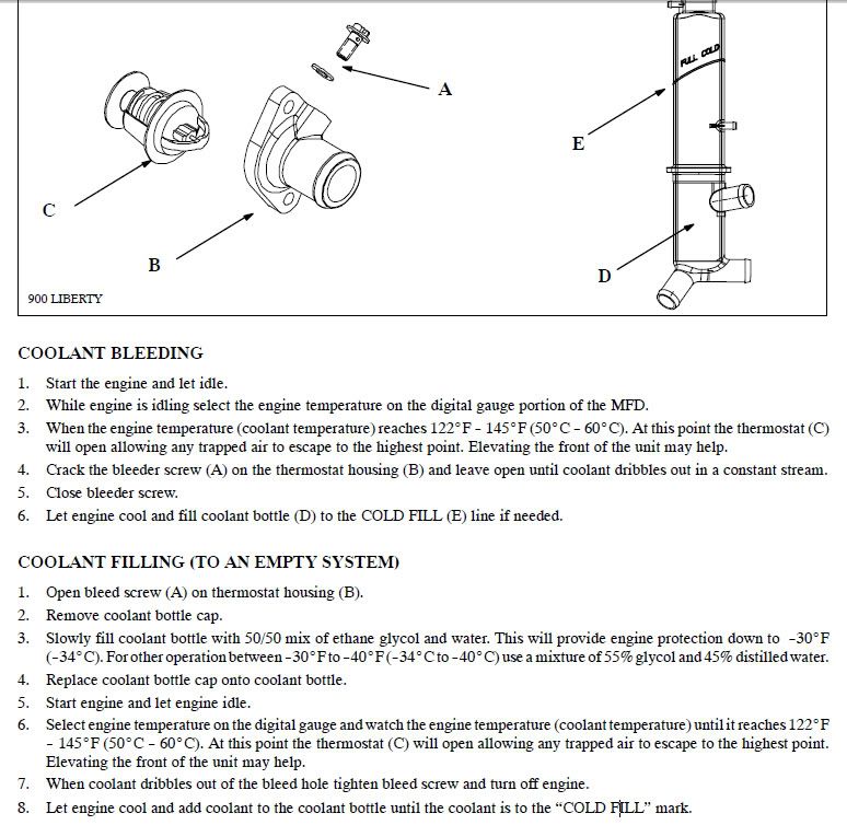

Finally got it completely together! Started on third pull with the new pistons! I bled the coolant system, do i have to bleed the oil or will that do its own thing? How much oil would you recommend i mix with my fuel? Obviously i have not obtained an owners/service manual yet or i would be not be asking but THANKS FOR YOUR HELP
Grant
yeah bleed the oil and coolant... grab yourself a copy of the owner&service manual here
