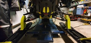

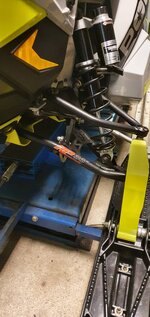

These are all black anodized now.
Why mess around with aftermarket when you can get replacements from any Polaris dealer if you still manage to fold an A-Arm with the braces on?
