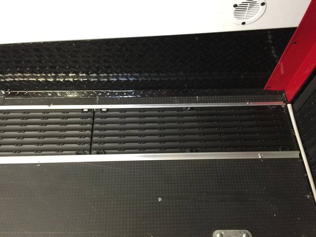

then we began laying down the sections where we wanted them to live and bolting them into place.
Both the Edge Trim and the SuperGlide itself are HIGHLY FLEXABLE!
This became very important as we had to bolt it down crossing over the transition angle from the rear ramp area into the flat center section of the trailer. Might not be super visible in this photo, but you can see all of the extra screws we put in place to make sure the "Bent" section of both the Trim and the SuperGlide stayed put over the "hump" in the trailer.

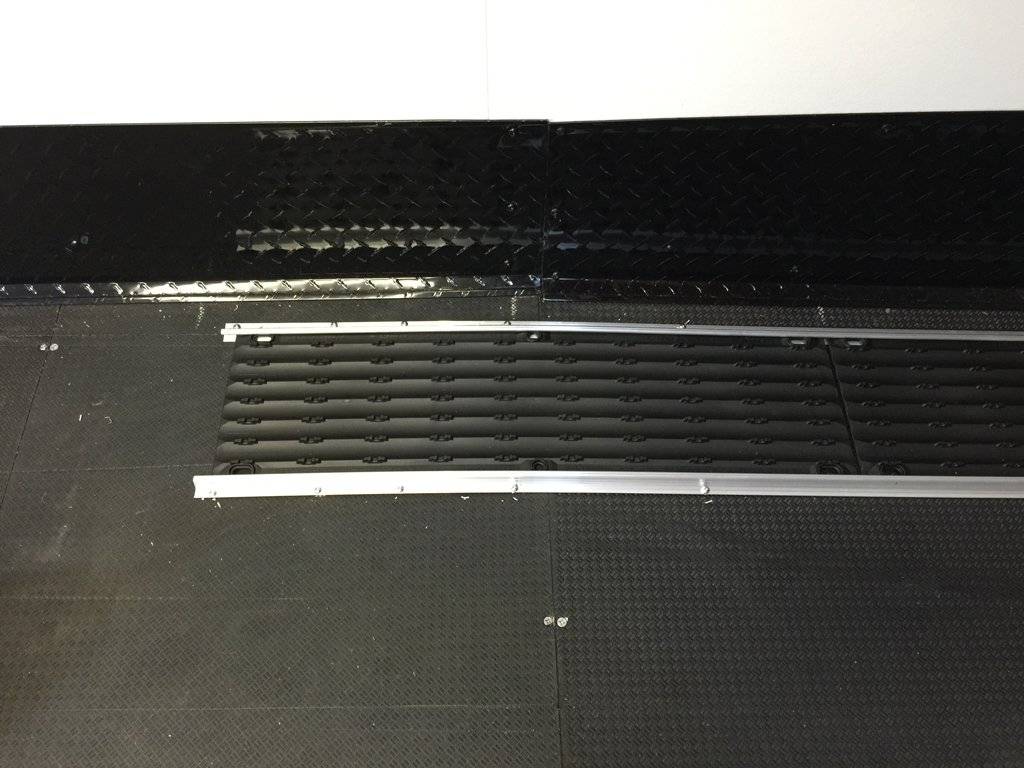

Continuing along the length of the trailer when we came to the wheel well we trimed both the Edge Trim and SuperGlide to the proper length and droped in the next section. Both the Edge Trim and the SuperGlides were VERY EASY to trim using a Jigsaw.
It should be noted that the Mirage Trailer comes PRE-EQUIPPED with a set of glides that cover the wheel wells.

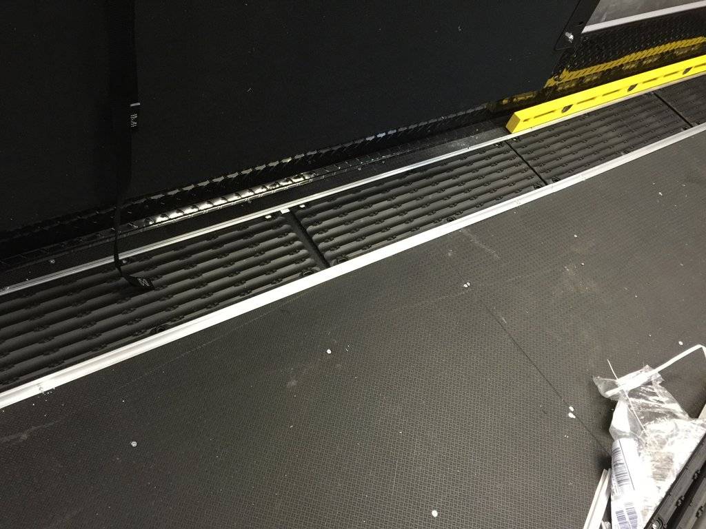

After measuring our 4 sleds for width between the skags on each of the sleds and from the outer edge of the skies, we determined the proper offset from the trailer wall and were able to use a simple construction ruler to keep our side spacing correct. Simple and fast!
Could just as easily laid down a chalk like or used a grease pencil.

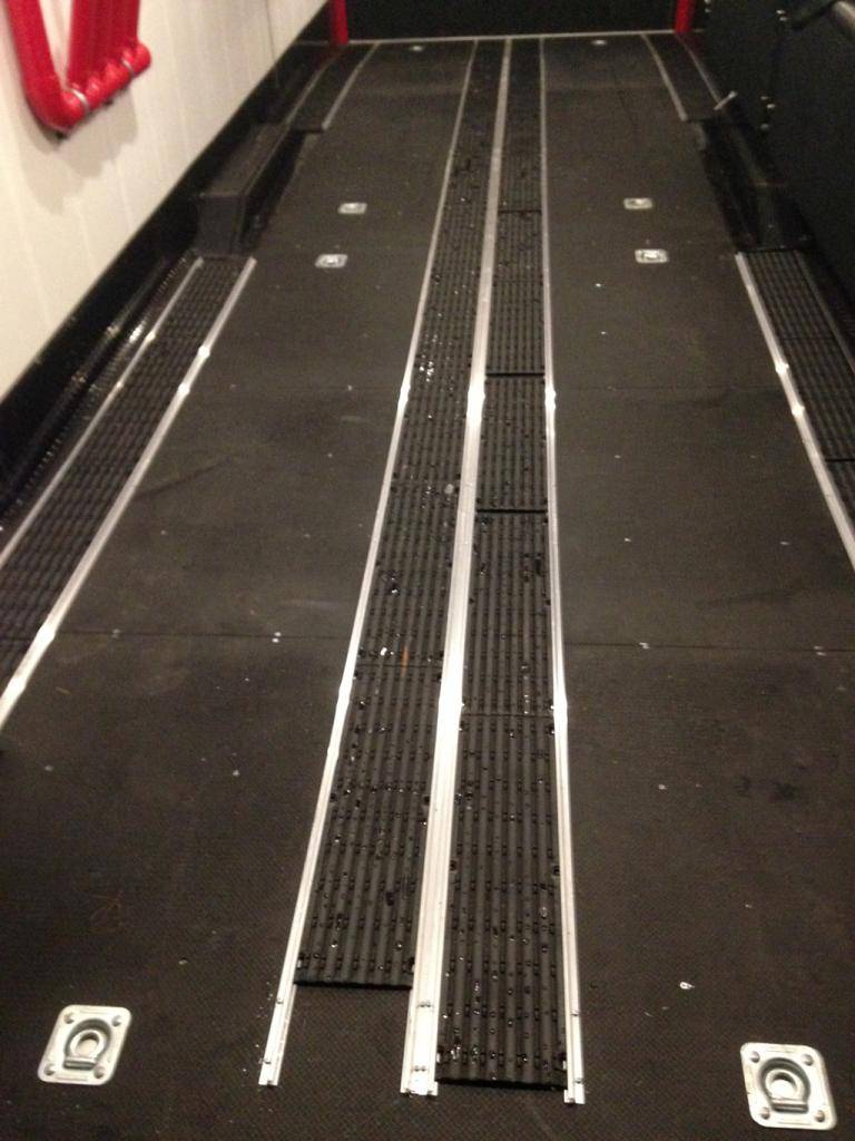

This is as far as we got on phase 2.
Track is laid from the rear ramp forward to the edge of the nosecone.
Next step will be to lay down the 45 degree angle "Turn" from straight to the exit ramp in the front.
Hope to get that done this week.
Now a couple NOTES.
NOTE!
All of the SuperGlides are FREE FLOATING inside of the Edge Trim.
That means I can push at one end of the trailer and 28ft away ALL of the glides move!
The glides MUST be bolted down in place at both ends to secure them from moving!
Silly me.
We didn't do that right away not knowing just how easily the glides could move. Drove a sled into the trailer, caught the glide and SHOT it out the other end!!:face-icon-small-hap:face-icon-small-hap
Live and Learn.
But the nice thing is that that allows for the natural expansion and contraction of the plastic guides from changes in temp.
