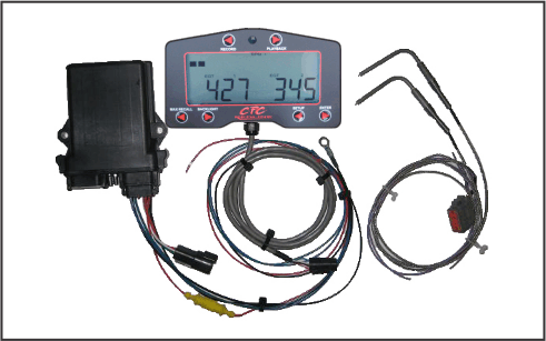

Wondering if this might not be the ticket?
CPC REDLINE GAUGE
CPC/Redline is proud to introduce the highest quality and most complete gauge specifically made for the snowmobile industry. This gauge was designed by snowmobile racers for racers. Its multifunction features allow this water resistant gauge to replace all the gauges on your high performance snowmobile. This gauge performs the following functions:
*4 Temperature sensor inputs for Water temp or EGT (2 exposed tip thermocouple sensors are included)
*Air Fuel Ratio capable (Requires AFR wiring harness and sensor)
*Tachometer (RPM 1)
*Digital Speedometer (RPM 2 Hall Effect)
*Digital Speedometer (RPM 3 Variable Reluctance for automotive use)
*PSI 1 for Boost Pressure
*PSI 2 for Fuel Pressure
*PSI 3 for Oil Pressure
* O to 5 Analog input for direct display of AFR
* Record & Playback feature (25 seconds)
*Completely Programmable including Pressure, Tachometer and Low & High alarm limits
*Customize your own back light with a rainbow of colors using RGB technology
*Super bright LED Red internal warning light
*Water resistant anodized aluminum (not plastic) gauge enclosure
*Runs on AC or DC power without having to purchase a converter
*Built in voltage regulator
*Displays temperature in Celsius and Fahrenheit

If your a tuner maybe lean towards the cpc or the prologger, if not and just like to turn key and ride, a/r and boost combo on the bar to keep things clean then water temp and fuel pressure elsewhere to check up on and diagnose occasional issues.
How are guys finding the prologger too complicated? I'm on the fence about what I am going to run, I like simplicity of just a couple gauges, but am also thinking of completely replacing stock gauge with a cpc or prologger so I can keep things tuned well and monitor all parameters.
It is not to complicated, it just takes a bit of use to figure it out. It was designed for automotive applications so there are many features we do not use. That was what I was refering to.
