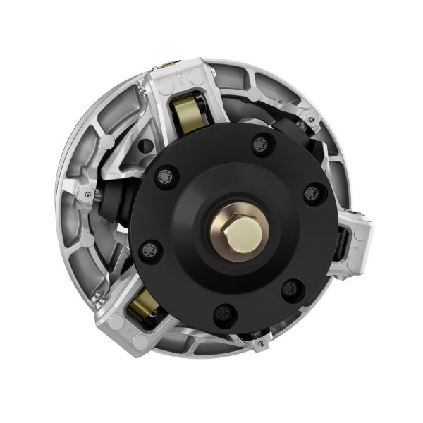

Looking at this clutch... and trying to wrap my head around it.
This is a discussion... a work in progress if you will to discuss and adapt our understanding of this new clutch.... so please bear with me and participate in the discussion.
The ramp...which now looks convex rather than concave.
So the tilt of the flywieght changes.
If the roller of the arm is in contact with the flyweight at rest... and holds clutch open to that point... and the arm cannot move at all... then, yes you would also change the engagement speed...
But... if the arm/roller can 'flop' a bit, like on a TRA, before it contacts the ramp...then it will not affect the engagement speed.
Edit:See post #16 below... I now believe that Xeiscountyduke's info from his Rotax contact IS, in fact, correct... and that engagement RPM will also be affected.
So my questions are...
Why is the flyweight convex now? (or do I need to change my brand of crack??)
Does the arm/roller have any free movement before it hits the ramp?

Ahh...
NO arm... Just the roller mounted to the top of the 'spider'
The ramp IS the ARM... like on a P85... Now I'm getting it.
The clicker then acts as a max travel stop for the flyweight??

Not sure it acts as a stop necessarily but it appears to me that the clicker moving will change the profile of the arm/ramp. This would take the place of the 1/8" allen weight pins that hold the weight/ramp in a P-85.
This roller design (to me) serves as the button and roller in a P-85.
This thing looks cool. It really looks like a better P-85.

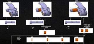

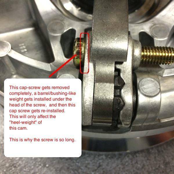

ADDING WEIGHT TO THE HEEL OF THE pDrive CAM.
Further tuning of the pDrive has you remove this bolt and you add a weight bushing under the head of the bolt and screw it back in.
Not long before adjustable flyweights like the Team Rooster or SLP lightning weights get released for these pDrive clutches.
This will allow you to tune to the engine power band well... by placing a weight, within the flyweight, at the tip, mid or heel.
This Clutch is VERY easy to understand now for me... very similar to a P85 in function... with some great new features.:face-icon-small-ton
Not long before adjustable cam-weights like the Team Rooster or SLP lightning weights get released for these pDrive Cams.
This will allow you to tune to the engine power band well... by placing the weight, within the cam, at the tip, mid or heel.

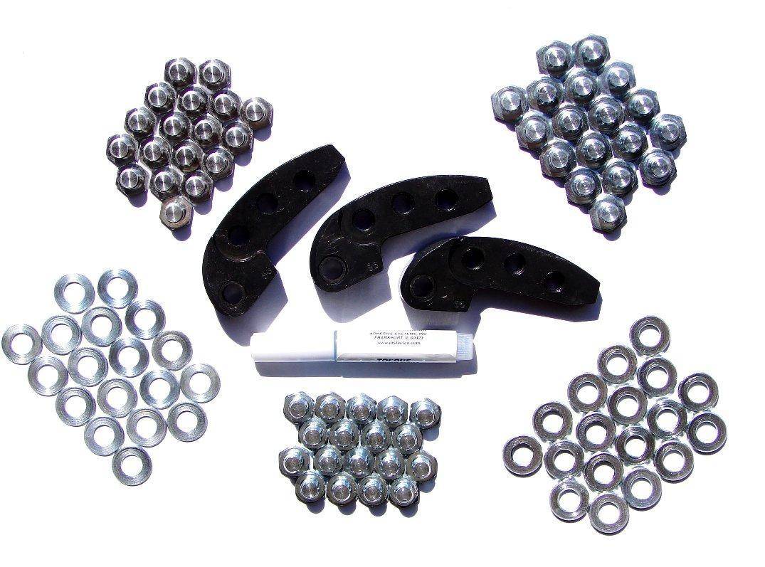

The pin weight in the TRA has everything to do with rpm and the pin weights is to set the TRA rpm baseline and control the shift of the bouncing Betty's ... While the TRA clickers are for fine tuning your rpm depending on elevation .... The reason Poo, Cat & Yamaha do not require pin weight is because the flyweight (ramp ) is the weight and can be purchased in the correct amount of grams needed for your riding elevation. Or for a more precise tune you can purchase flyweights with a baseline weight for your elevation which comes with set screws you insert into the flyweight to fine tune.
DPG
DPG

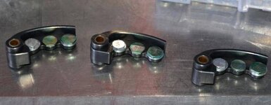

The 'adjustable' aspect is not just for total weight of the flyweight, but WHERE that weight is added within the flyweight.
A weight with the same profile and same overall weight, but more weight at at the tip will run differently than one that is the same but carries more of that weight at the heel. Adding more weight on the clicker adjuster bolt will have different effects than adding it just at the tip of the flyweight for the pDrive.
As I mentioned above... in the TRA designs... many tuners were using different weight arms... in addition to adjustable pin weights to add different parameters to the tuning...an adjustable flyweight with multiple weight positions would add this dimensionality to the tuning of the pDrive as well... and be SUPER EASY to tune as it looks like you wouldn't even need to remove the flyweight from the pDrive to add/subtract weight....
I've seen Tundershift arms, LW Dalton arms and quite a few others for the TRA... We'll see if this this concept is offered in a flyweight from for the pDrive as well.
Ski Doo has a system to load the heal of the weight for the pDrive for the mountain sleds.
Of note...(many will have already known this)... The pDrive was released last season on the 600RS sleds... but, it did not include 'clickers' on any of the models that I saw.
