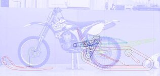

Here is me and my buddys project last winter.
Not really a new design. More like a home made Timbersled MH style.
Ski Doo MXZ skid with FOX float.
Now waiting for delivery of our new bikes, KTM 500 EXC :face-icon-small-coo

Here's where I'm at now... My whole front end is done and I'm running a gen 2 Simmons. I have to cut down the track and make custom suspension arms. But it's coming along nicely.

If you don't mind me asking, where did you get all your sprockets and brake system? I'm still tracking stuff down like the chains, sprockets, drivers/shaft, brake system, and tensioner...
We took the break disk and caliper from a Ski Doo MXZ. Too big I think. The disk had to be placed on the side of the frame, not between. Thawing snow dripped from muffler on to the calipper causing it to ice. Had to make a cover. I would have chosen a smaller, like from a rear brake from a small motorbike.
The chains and sprockets was bought from a industrial transmision supplier.
We also made a special spring loaded chain tensioner (the chain from motor)
I made several stalls before installing Recluse . That caused a great force on the tensioner on the unloaded part of chain. It broke. The spring is dampening the stress on the tensioner and also maintain correct tension.
Nice, keep up the good work!
What track and skid will you run?
Stock snowmobile suspensions have the upper wheels on the outer side and springs on the inner side. That was a problem when we cut the track. We ditched the springs and went for FOX float in rear.

so if you ditch the torsion springs can u replace the rear shock with a coil over or air shock using the same linkage and all, or do you have to reengineer and strengthen the mounts? In the past I have been running with the torsion spring setup, only I run only 1 of the springs for the right stiffness, I want to use a coilover going forward, and get rid of my ghetto 1 spring method, it just seems like I will need to beef up the mounts and maybe change them to accomodate such a shock and spring? I run skids out of 2000 and newer ski doos, polaris and arctic. My main question is if u replace the torsion springs with a coilover can it just be put right into the system or does it require more than that to make it still move correctly?

As far as I know it's impossible to keep the torsion springs when the wheels are moved due to a narrower track. At least on a Doo suspension.
The length and stroke of the new shock is other than stock. The mount had to be made stronger and a bit different.
A coilover would probably work. We did'nt know what spring load was suitable. Air shocks are easier to adjust.
