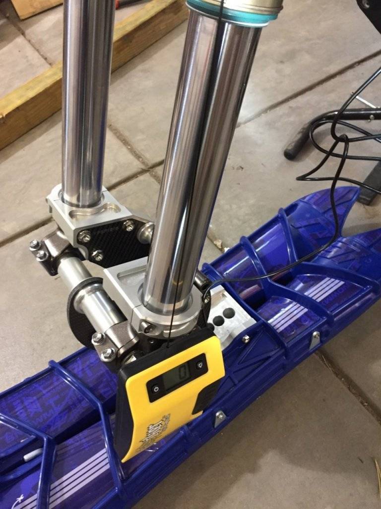

When a customer wants us to set up their bike, and that set up includes a front sag set up. We spend over 2 hours tearing down forks and working with springs and shims to get the front fork sag set correctly. It is a fine line between proper spring length and shim spacing. If you use to many spacers the spring will coil bind. Sag is the first and most important setting on a snow MX suspension!!!!! Every other setting is based off the front end sag.

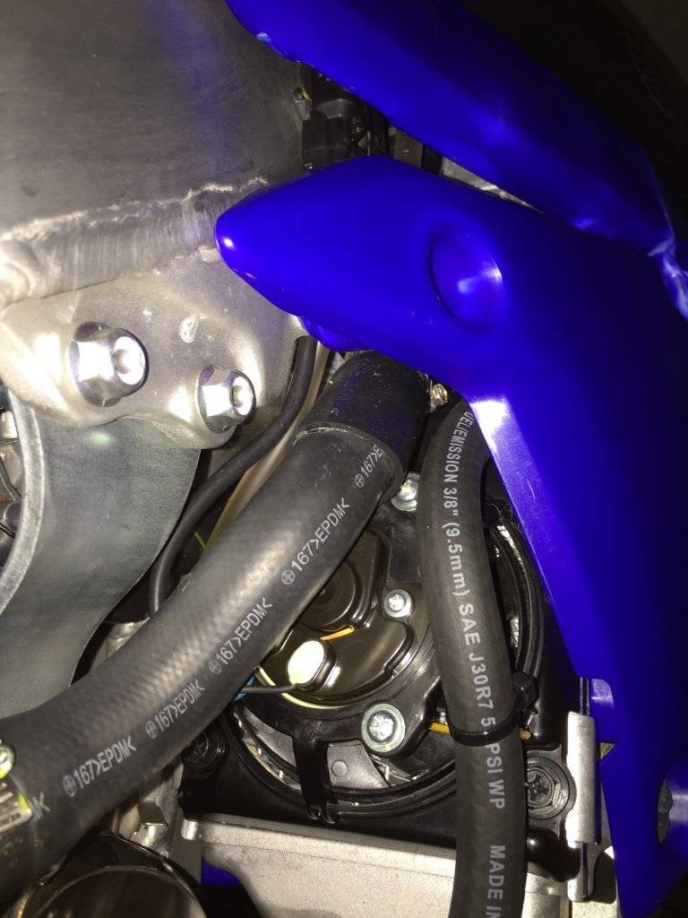

Yamaha GYTR electric fan
( The fan kit is so easy to install and helps on the warm days so you do not have to keep the eagle eye on temperatures when you are working it hard. )

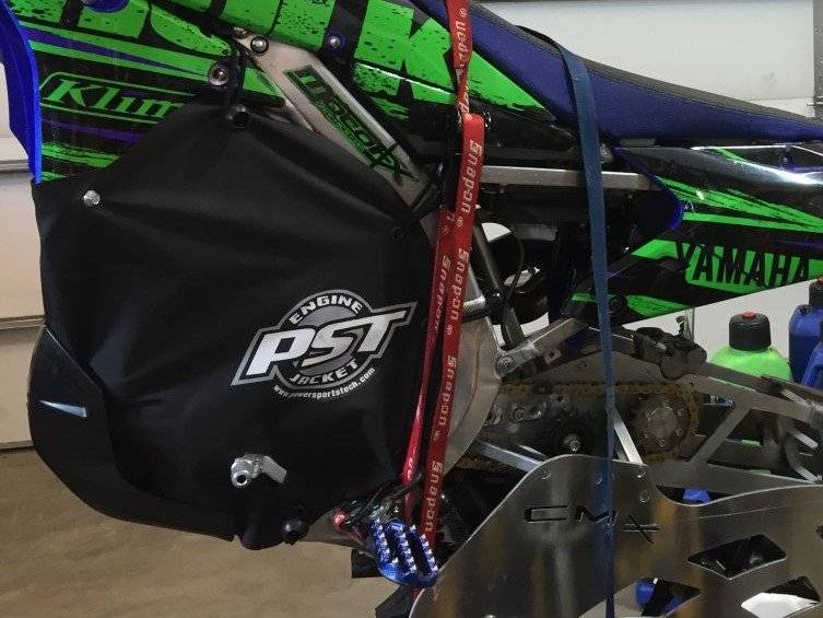

PST engine jacket
( After full testing we are very happy with the results these units give us. They are easy to use and can be rolled down when the temperatures get warmer. and even removed all together for your April and May riding. )

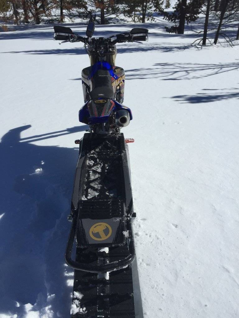

Thor Review:
Stock 2017 Camso DTS 129.
We saw that the DTS was UGLY!!! Our custom RMS MX graphics sure helped its curb appeal.
The riders this season felt that the value of this system put it in line with the Timbersled kits for the performance verses the money spent.
The front ski takes some getting use to, but will preform quite similar to a Timbersled ski. It has some push and ill manners compared to the Yeti ski. The rear suspension in the system leaves a lot on the table. There is not much spring adjustment, and no adjustable dampening.
The cargo area is built in and you do not need to buy anything but two ratchet straps to hold in the gas can we sell and the cargo bags.
The mono rail skid and track are the huge standouts on this system. Having a track that has a full 2.5" deep paddle all the way out to the edges and moves so much more snow is a big plus. It will out climb all of the other systems on a deep day. This system just moves that much more snow. The mono center rail allows the track to bend and flex around the single center hyfax on the trail giving it the side to side roll you are after on the hard pack. Some riders even asked if this bike had motor mods because of the way the track moved the snow with such ease.
The chains are super easy to adjust and great to maintain. The only down fall is the track drive chain is kind of hard to get the chain lube to.
This system is value priced and delivers a good system for the money. It is HEAVY, the front ski could be better, and the rear suspension leaves a lot to be desired, but for the money it is in a position to give Timbersled Raw a run for their business in the cheep market. Camso's customer service and warranty department is great to deal with and parts are shipped fast to help the customers. Camso even published TSB's for corrections that were need for two different issues that were found in the field. As a dealer this was very proactive. All in all, it rides well, the track is great, and you can not get better performance in this price range. The Camso DTS 129 was $4799 for the 2017 season.

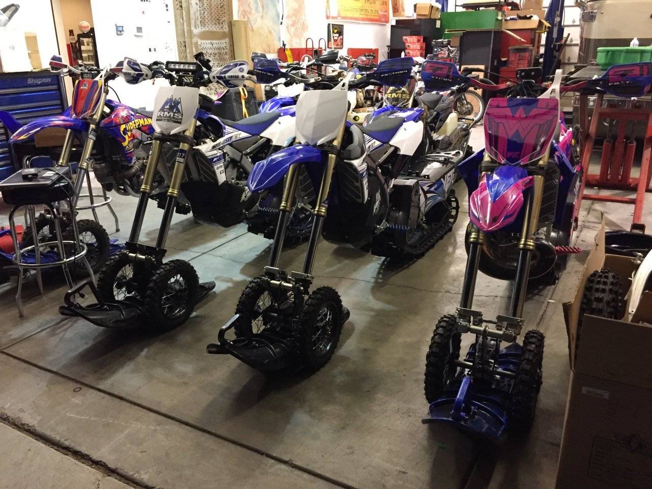

It's now time for the weigh in.
All weights were taken with the stock fuel tank completely full of gas, and the straps on the foot pegs in the same position. Take notice of how the attitude of the bikes are different hanging from the straps.
Wonder Woman
2017 Yamaha YZ250 2-stroke 2017 Yeti Freeride 120 - 265lbs.
Robbie Madison
2016 Yamaha YZ450FX 2017 Yeti SE Robbie Madison 129 - 312lbs.
Hulk
2017 Yamaha YZ450FX 2017 CMX BK 129 - 321lbs.
Superman
2015 Yamaha YZ450F Aerocharger 2017 CMX BK 120 - 336lbs.
Thor
2017 Yamaha YZ450FX 2017 CMX BK 129 - 345lbs.
