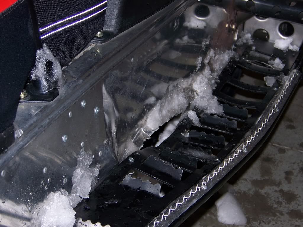

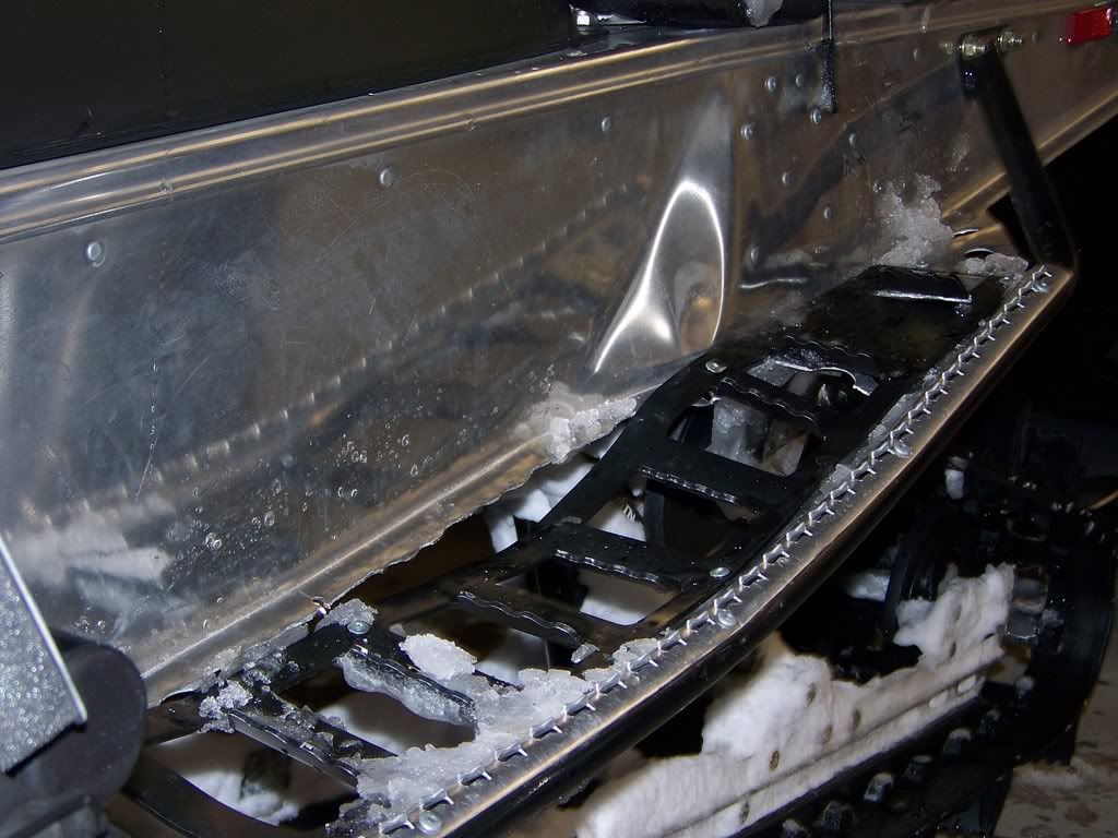

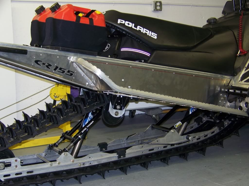

post up some pics of your tunnel. you can probably do the cr side kit and save a little coin as well. The VE tunnels are great but get a little spendy
i wheelied over in a chute last year and wrinkled my tunnel, here's some before and after pics with the CR kit
BEFORE
[IMG][/IMG]
[IMG][/IMG]
[IMG][/IMG]
AFTER
[IMG][/IMG]
[IMG][/IMG]
